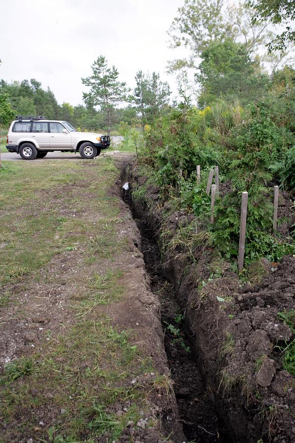

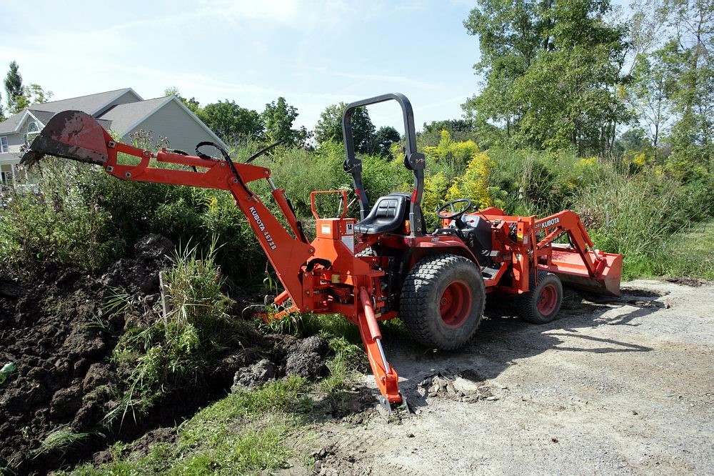

i have a b-4672a on my b2400 -- love it -- installed it out of the box --
-- the subframe was a LOT of work to install, but critical -- also, i too have the upgraded toplink -- or whatever they call it -- :D
-- here's pics --

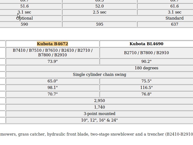

/ B Series Backhoe ? #18
A BL4690B would be the original backhoe that probably would have come on your tractor. I believe it was only available in a 3pt mounting version, but required an upgraded top link bracket that wrapped over the top of the 3pt housing. It still wasn't an ideal setup strength wise. The BH76 is what you would be looking for if you were buying a new Kubota hoe, it has the good 4-pt mounting system. It does have it's own seat, only the BH76 for the B3200 uses a swivel seat on the tractor. If you are going with a Woods, I would stick with the BH70-x, the BH80-x would really over power this size tractor IMO.
/ B Series Backhoe ? #19
There is no such thing as a traditional Kubota 3 point backhoe.
Which word or words do you have problems with?
Is it that I did not preface it with SCUT or CUT?
attachment.php
As listed on this page:
Poplarville Sales & Equipment - Kubota B-Series
The Kubota B4672 and Kubota BL4690 are 3-point mounted. When I went to buy my BH two local dealers had B4672's they were offering and referred to them as 3-point mount and advised of the HD toplink.
