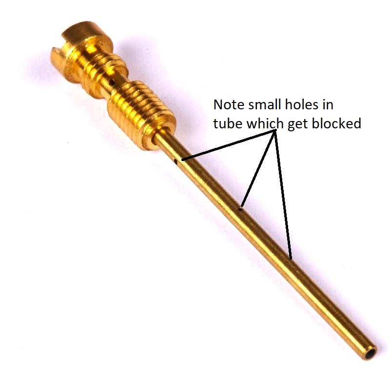

My Husky/Craftsman 917.203900 wants to stall at minimal idle speed with a rough idle.
I checked the plug firing with a spark tester, but it has good spark on both cylinders at speed and idle. Apparently the carb idle circuit has a problem, or the mixture adjustment maybe be off. I doubt if the carb needs a rebuild. Before I get into it, I am going to pop the hood and try the idle adjustment and check the fuel bowl for water etc. Nice engine in a questionable mower? The RS 800 CVT Variator requires constant cleaning to keep it functioning. This requires about 3-4 hours as the fuel tank has to be removed to access the CVT. I have installed a temporary fuel tank on the rear of the mower to eliminate constant removal of the fuel tank. Not handsome, but it functions! The original install according to sears manual was to be an under the fender tank, this one came with the under seat tank, a losing preposition!

Since you moved the fuel tank, that's the first suspect. Check fuel flow and tank venting.
Poor idle is often due to poor mixture which in turn is due to gum in the jets from gas evaporating in the carb. The idle jet passages, being the smallest, are the most affected. Disassembling and cleaning the carb bowl and jets is usually a first step.

Actually for me first step is spraying around the intake gaskets with carb cleaner to check for air leaks.

Most B & S carbs incorporate an emulsion tube to break up the fuel and mix it with air.
In the B & S world it is called: Carburetor Nozzle 299740
The main jet is unscrewed to access the tube.
Use a flat screw driver that exactly fits the slot in the main jet or you will end up in a big mess.
The holes often need to be poked out with a fine strand of wire. You cannot get it clean without removal!
See photo.
Dave M7040

No removable emulsion tubes on these. If your fuel supply is good, you can try to drain the crud out by removing the solenoid on the bottom side of the bowl. Beyond that, if you're not experienced with this carb- you may want to have it serviced or simply replace the carb (OEM). You can try removing the shroud, the top cover (3 screws) and finding the two holes that have the brass fuel pipes on them, give them a quick blast of carb spray to clean the mains. Then quickly put the carb cover on and start the engine and run it for minute only to see if there is improvement before you put the shroud on. If not done quickly the cleaner can distort the jets o-ring or the seal below the pick up tube.
