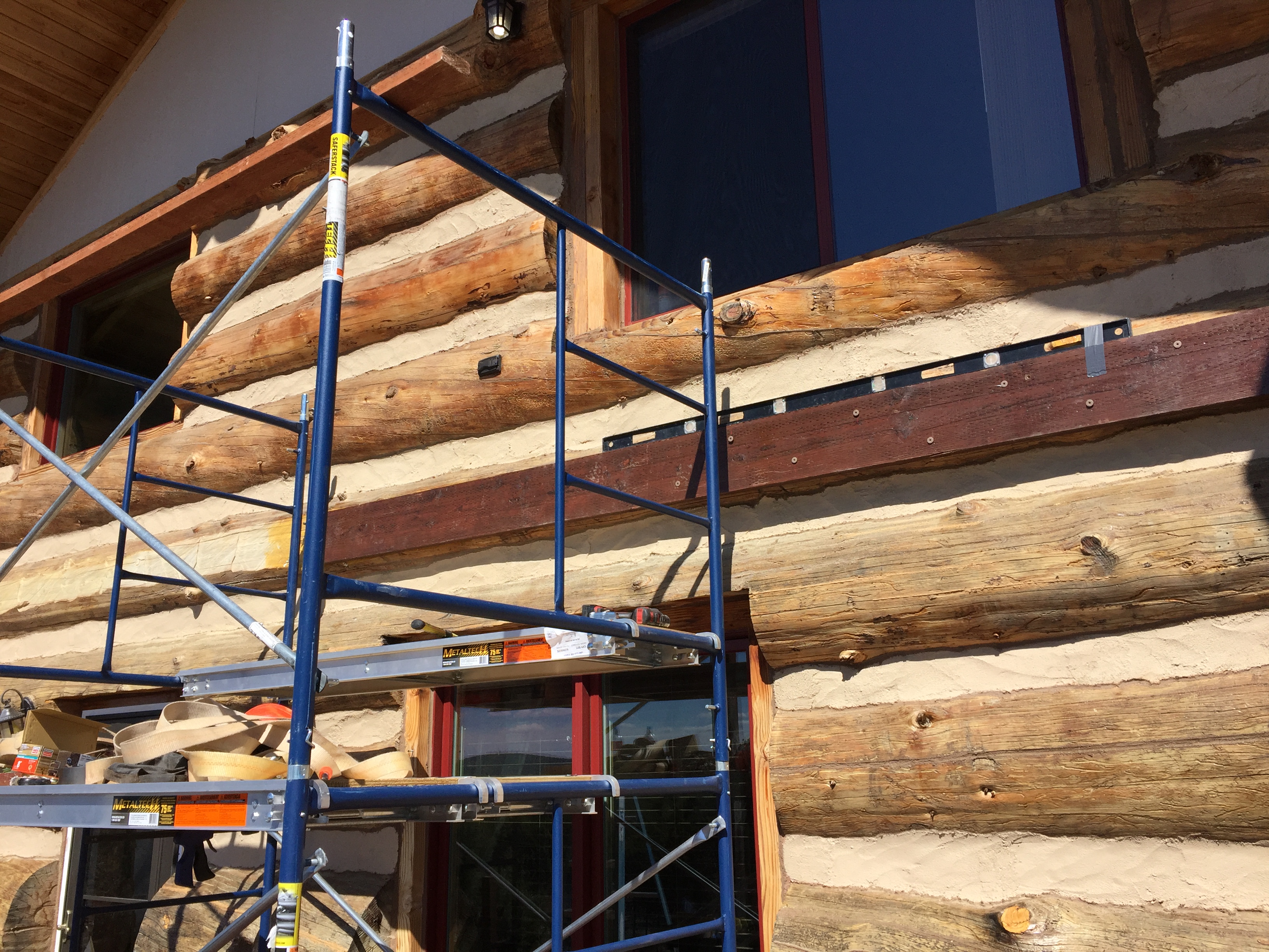

I was able to get one of the 16 foot ledger boards up today. Heavy board, climbing up and down scaffolding, trimming high spots with chainsaw,......
Whew, I am bushed.

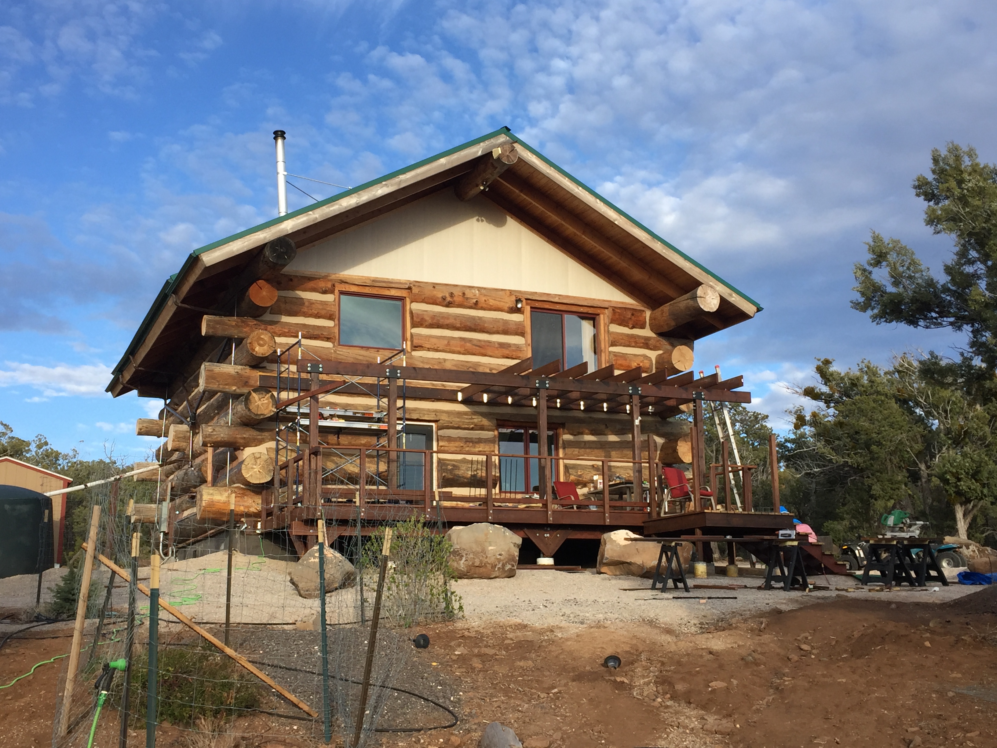

Finished the other ledger board and I have half of the joists up. Slow and steady. I am 70 and working alone, so safety comes before speed. No deadlines makes it easier.
   / AZ ranch
#1,214
I am getting to the point where I need to order the door for upstairs. I originally thought French doors, but they both do not need to open, so probably one of those where one half is window and the other half the door. I know there is a name for that, but i forget it.
Anyway, my wife would prefer an out swing. What are the pros and cons of an out-swing vs. an in-swing?

The hinges on the outside would not be a HUGE concern, as this is a 2nd floor deck with no outside stairs. If somebody wanted to break in, it would be a lot easier to break a downstairs window than climb up and try the upstairs door.
And I have an 8 ft overhang, so its somewhat protected from weather, unless its raining sideways.
