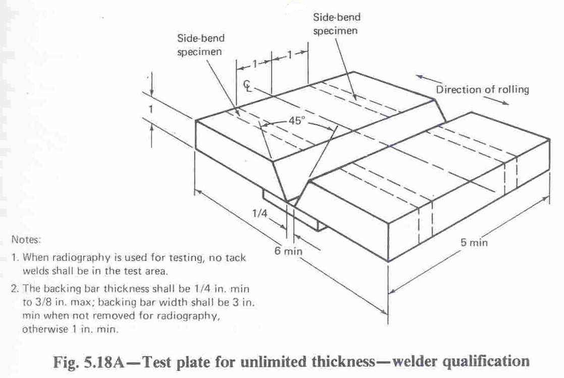

The latest AWS D1.1 book I have is 2008. I'm not finding anything on B2.1 and D1.1.
Here in the Seattle area all structural welders have to pass this test in the 3-G, and 4-G. WABO / Washington Association of Building Officials requires the welder have his card signed every 3-months. But I have had welding inspectors reject my card. Saying it was to old, and I had to retest.
