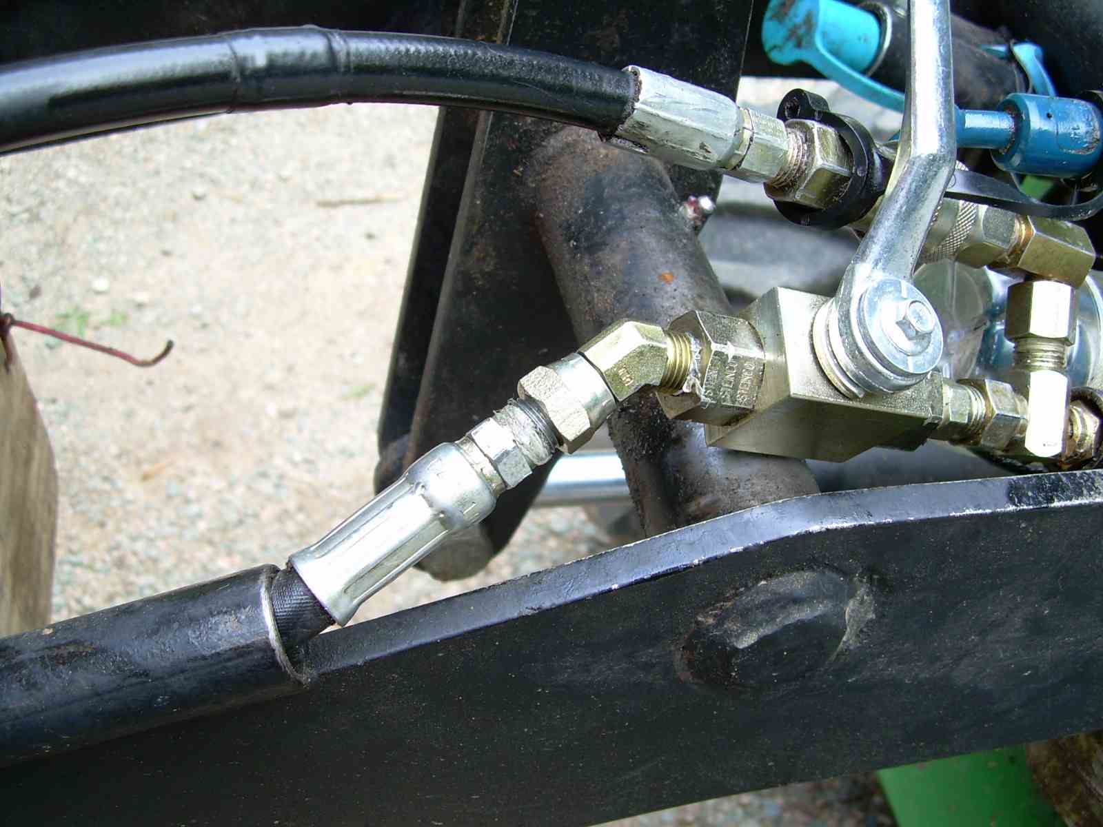

Recommended Change - I had some people at work look at the auxiliary hydraulic change today and they were concerned about the sharp angle of the hose on the left side. I added a 45 degree fitting. It's called a 1/4 NPTM X 1/4 NPTF 45 swivel. The surplus center part number is 9-1503-4-4. I have attached a picture. I only used one fitting, I guess this is enough. There is still a sharp turn going into the tube. J_J, does it look OK to you.
Another option would to be to run the hose outside of the tube.

Bob, Anything is better than 90 degree turns, but some times it is necessary. If you have a 90 degree fitting on a line, in theory, it slows the fluid somewhat, and adds a little heat, but in your case, just to move the QA cylinders in and out would not make a lot of difference. Where it has the most effect, is in a high pressure line, moving fluid, like running a hydraulic motor. Actually a straight line is not good either, for this reason. The pressure and pulsations will destroy some hose and fittings if plumbed up wrong. A bend is required in most hose or metal hydraulic line to absorb the expansion and shock. Have you noticed the hydraulic hose move as you energize them. In time it will wear on the hose and fittings if not taking into account, like the hoses going through a hole an the front of the PT. One of my steering hoses burst because of wear. It rubbed a hole right through the hose until the pressure blew out the remaining hose.
You do some good work. Keep those ideas coming.

J_J, I understand your point. I have noticed the hoses flex when you pull and push the quick attach lever. In addition though, a sharp bend like I had would put a lot of stress on the hose fitting. I thought that might be his concern. It looks like adding the 45 is probably enough.
Thanks again for your advice.

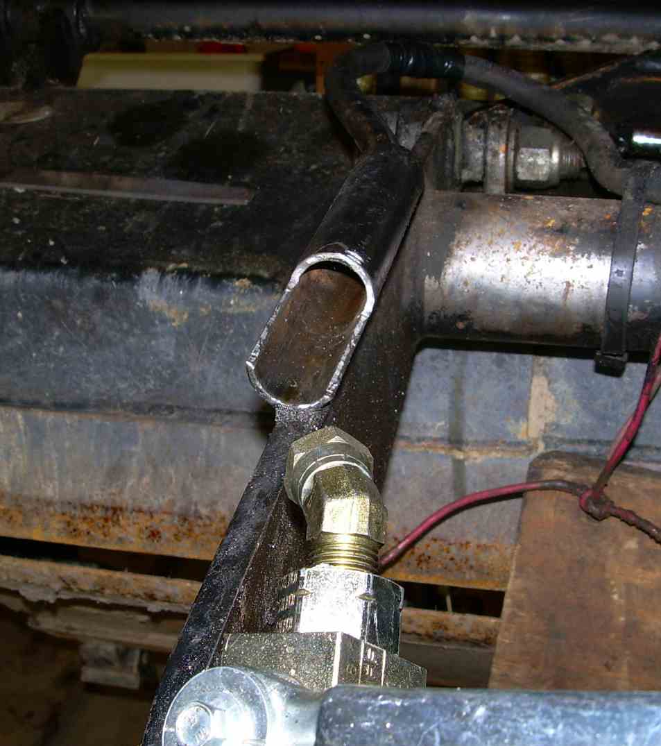

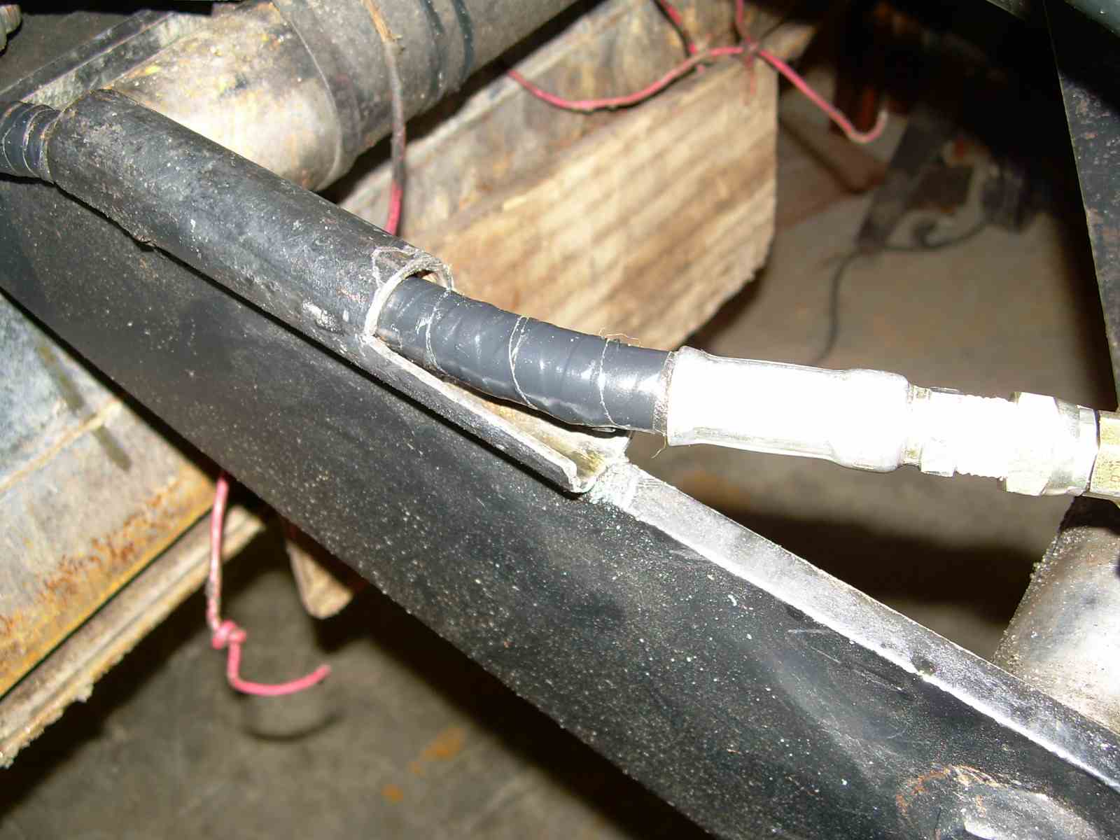

I made a cut in tube that the hose from the quick attach cylinder goes through. The cut is about 2 inches long. This relieves stress on the hose. Be sure to clean off burrs if you do this.
Bob Rip
