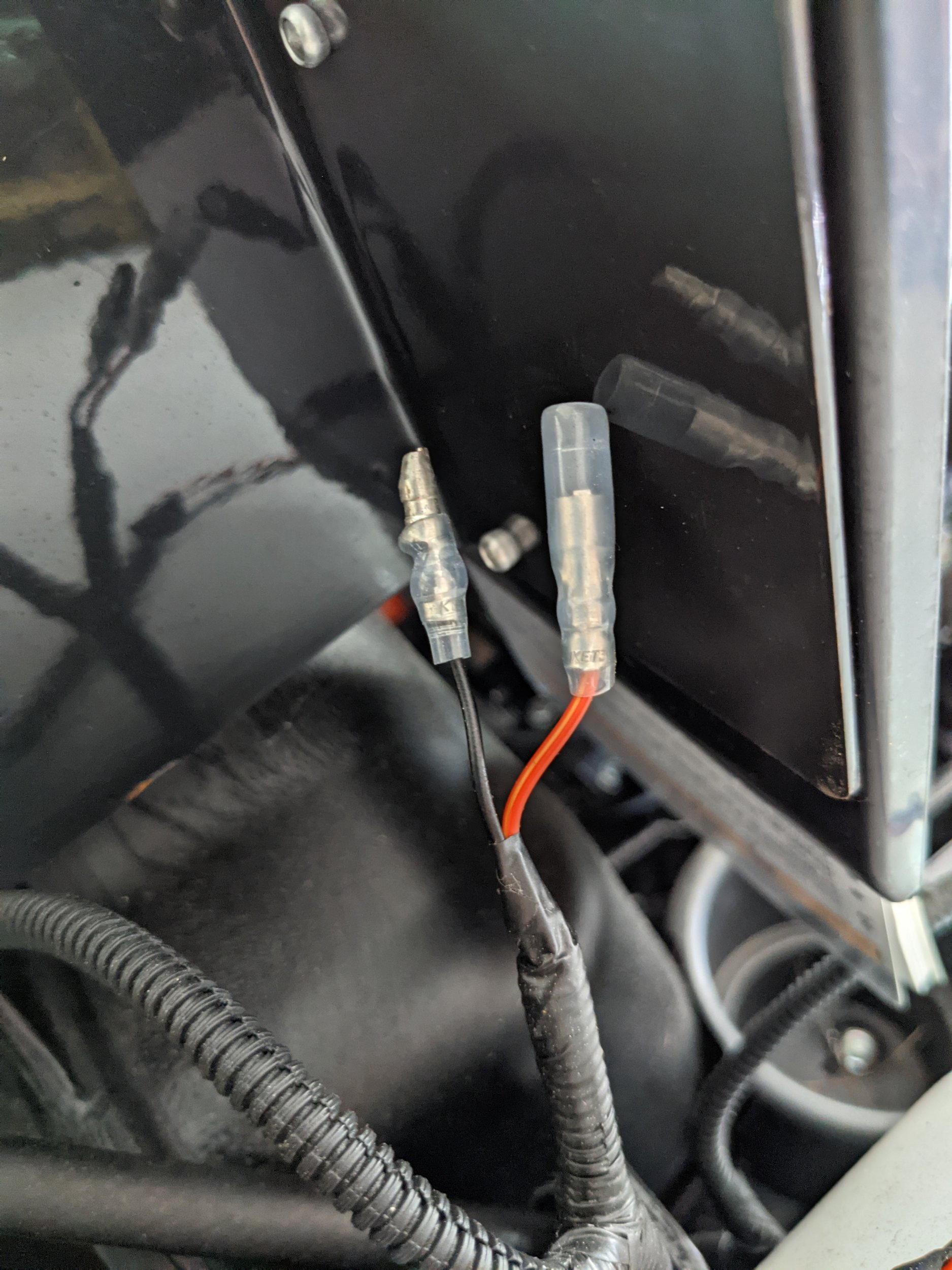

I'm looking to connect a light to the aux power provided on the right rear of the tractor. Does anyone know what the name of the connectors is? I'll need to purchase connectors to go on my light, however I don't know what they're called. Here's a picture of the tractor connectors.

Believe those are bullet connectors

This is exactly why I joined these forums! Thanks for the very timely responses!

if the lights are permanent cut and splice the lights in. if adding several different items put a double wire trailer plug on it and interchange that way.

Sadly the "bullet" is offered in more than one size. Measure your male connector accurately before you buy.
It looks to me like these wires are 18awg, in which case I probably need the connectors for that size.

Ok, I did not know that. I'll be aware of that when buying. Thanks!

For what it's worth this is connected to the headlight fuse

Anderson power pole connectors are the way to go. They allow disconnect capabilities and lock together side to side. Each time you disconnect them, they wipe the contact point helping to provide good contact. The small single units work up to 45amp. I use them on battery to hook up trickle charger.

Be sure to test the bullet connections for power before you do anything.
With my headlights on they have no power showing
there is a work light fuse showing in manual pic but the 2025 fuse box is different without space for it.
