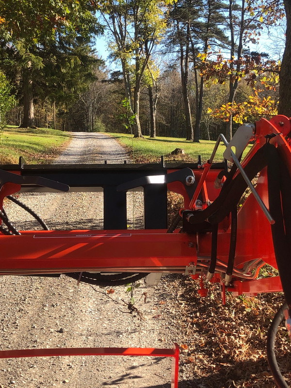

It is a Titan tree puller but it will be used by me as a bush and bramble puller and so far I really like how well it works. (I haven't had much success on this stuff with the grapple.) I first tried this small olive w/o any ballast just to see and all that happened was the rear of the L2501 raised, but after connecting the ballast box, even though the ground was hard and dry, it had no problem yanking it out along with a few barberry, rose and other small to medium olives.

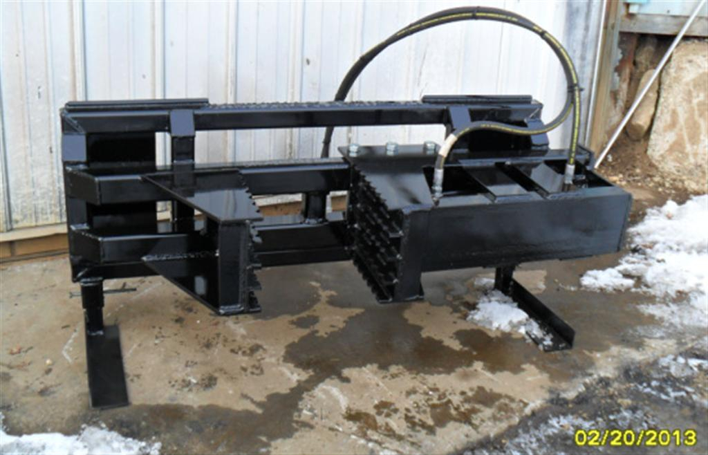

I have a similar Danuser Intimdator that it’s real good for weed trees and bushes. Grip low, lift and driving forward increases pulling power while being stable. Sure helps this old man keep up.

I worked on pulling olive and rose again yesterday, it's so easy with this attachment I only wish I'd have bought one earlier. I was pleasantly surprised my tractor was able to pull out this fairly large multi olive bush/tree especially given the dry ground.
Perhaps more surprising (and equally important) is how it can grab on to the smallest little stalk like this single multiflora rose plant.

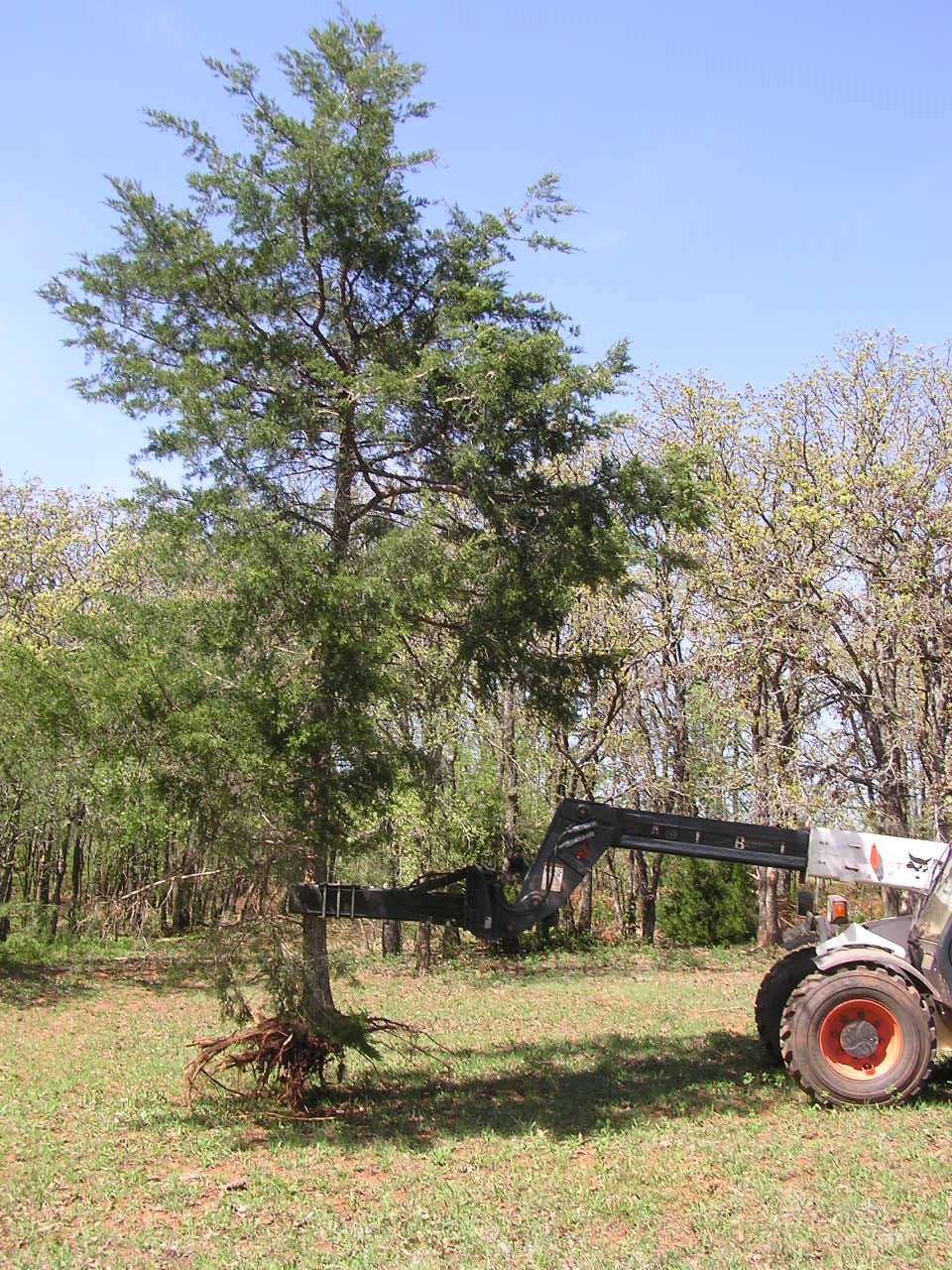

For trees you should consider this clamp style tree puller:
Or the Long Arm style that I have:

It’s Danuser Intimdator. Yes hydraulic off the 3rd function. Well designed with excavator teeth and cutting bars to break roots of bigger stuff. Cost more but does so much more.
Sure has saved much manual work. It’s the little stuff like olive, privet or multi flora rose where it where it really shines. Easy to see, reach, position and pull. Stack a pile then grab to haul off.

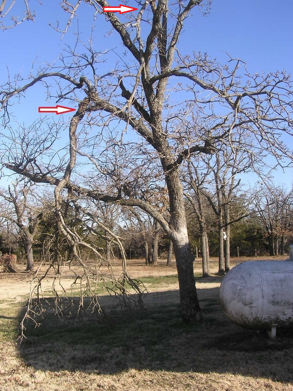

I used mine last year after an early ice storm broke branches because the leaves were still on when it hit:
Removing a broken branch after the the leaves fell the next month:
