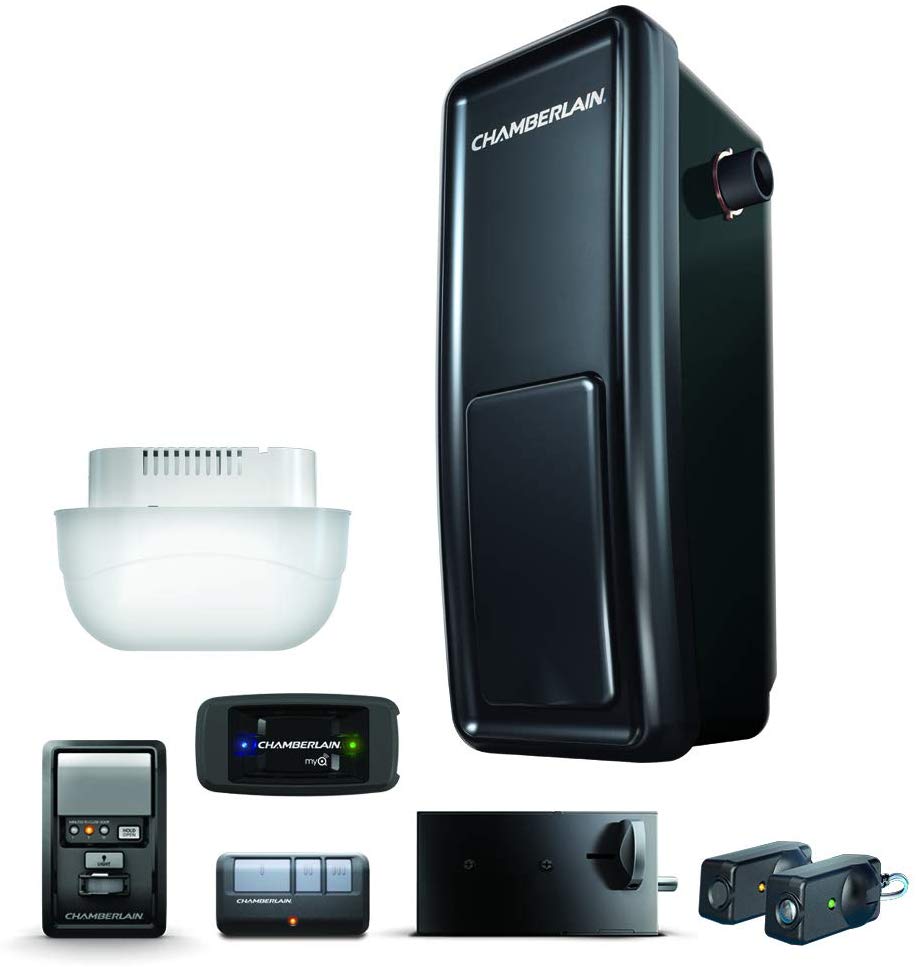

Considering adding an automatic shop door opener to my 12x14 rollup. I spoke with Liftmaster and Chamberlain tech support. They both assured me that these new jackshaft direct drive openers are the best and most economical option. I know you guys are going to have plenty of input on this one. The RJO20 is the one they recommended and is good for up to 14 foot rollups.
Give me your insight please!
https://www.amazon.com/Chamberlain-...o20&qid=1576713165&sprefix=rjo,aps,163&sr=8-1 Chamberlain.jpg

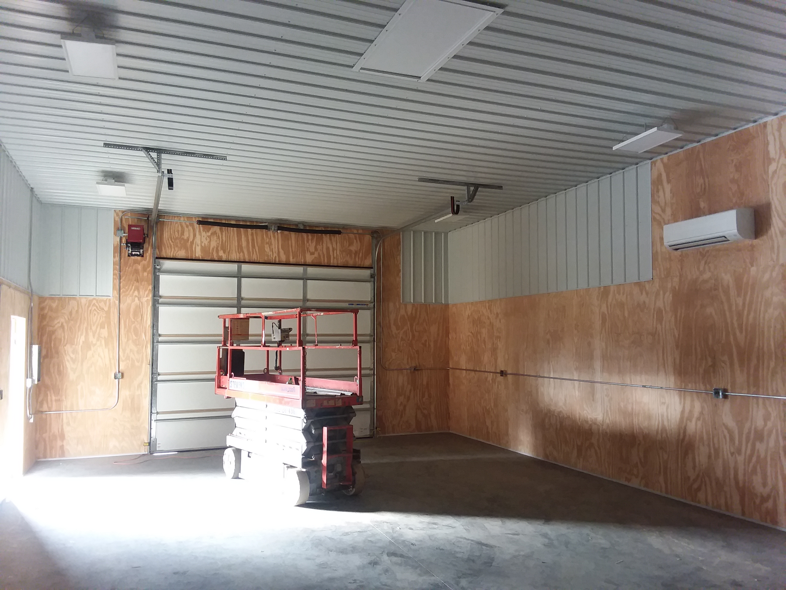

There is virtually no drop to my track at all. And the jackshaft openers require the weight of the door to close it. So, once the helper spring has done it's thing, the door is starting to fall, so if you disengage the opener, when the door is open, it lets go of the door, pusher spring starts it closing and gravity does the rest.
I have all kinds of Diesel generators, but my last ditch back-up is an air cooled Yanmar, and it's a real treat to start in the shop with the door closed! I guess, I could leave the door open a few feet, with something propping it up, and direct the exhaust outside, but I never thought of that in the moment.
In fact, the door runs so close to the underside of the truss, that I had to notch one out and put an idler wheel to compensate for when sun is shinging on the dark door and it bows, catching underside of the truss!

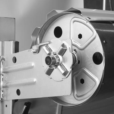

Does anyone have pictures of these being used on rollup style doors? You know, the ones that wind up on a round drum type? Like this.images.jpg750_bracket.jpg750_bracket.jpg
