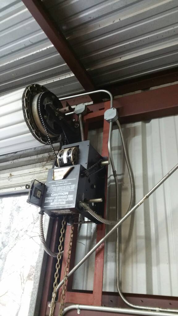

Does anyone have pictures of these being used on rollup style doors? You know, the ones that wind up on a round drum type? Like this.images.jpg750_bracket.jpg750_bracket.jpg

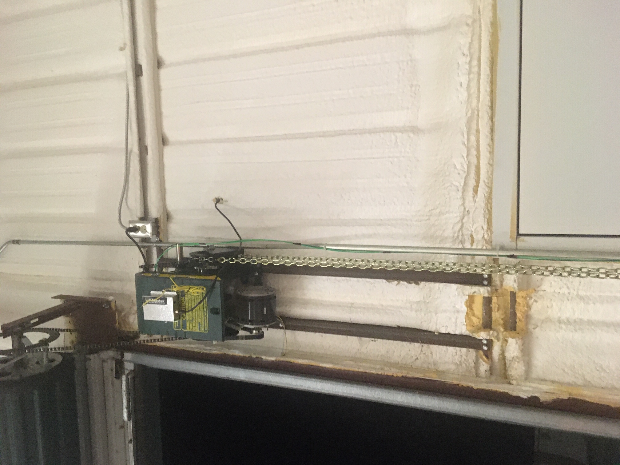

I have three of these in my shop installed in 2016 on conventional track doors. Love them. Quiet and all kinds of remote options. Mine also have the automatic deadbolt lock.

I have a Manaras Opera Model MH on a 12 x 10 rollup door in my shop
It works very well. I bought an optional limit switch for it that can be wired NO or NC that controls an outside light.
The outside light has a photo cell, so when the door opens at night the outside light comes on, and when door closes light goes off.
During the day or course, the photo cell keeps the light from coming on.
