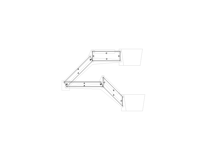

The most foolproof solution is the articulated parallelogram mechanism
but it has the drawback of adding additional dead weight to the loader.
/ Auto leveling FEL? #8
</font><font color="blue" class="small">( The most foolproof solution is the articulated parallelogram mechanism but it has the drawback of adding additional dead weight
to the loader. )</font>
Here is a drawing of the above.
