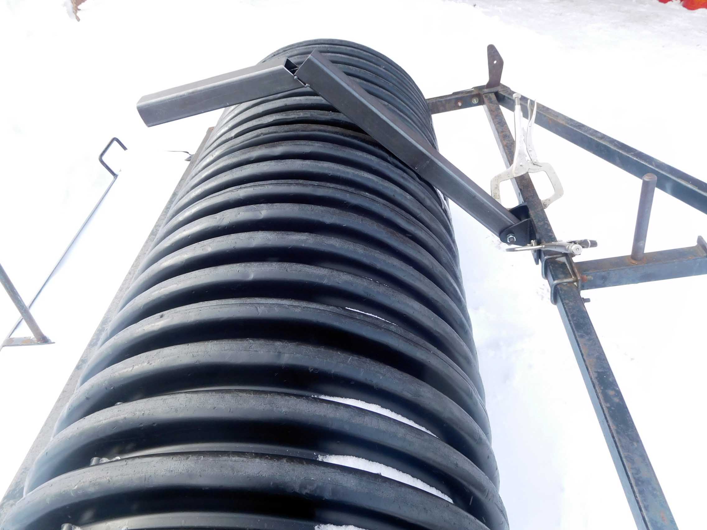

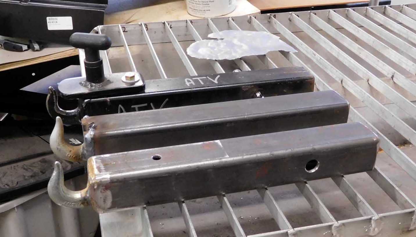

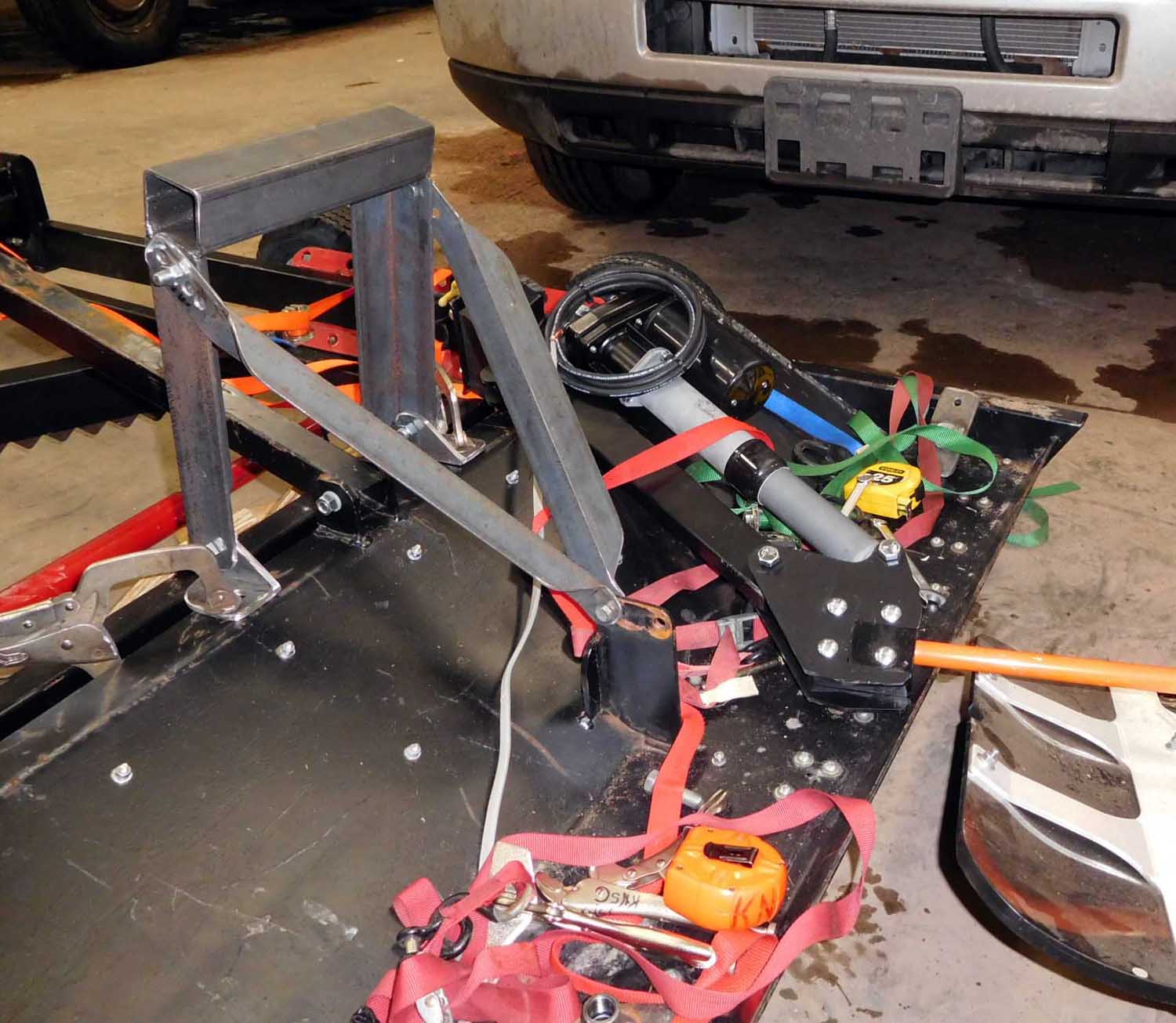

here is a couple of recent projects. Sure glad you folks suggested a better helmet!
