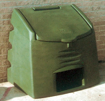

The pieces of coal range from slightly bigger than a golf ball to about a piece 8"x4"x3". Thats a bit of a guesstimate. Would an auger not be harder to set up than a belt and would it transfer the material without getting jammed???A belt with paddles sounds like an easier method. Would the weight of the coal stop the belt from turning???
   / Auto Coal bunker
#9
Here is a picture of the type of bunker im on about
   / Auto Coal bunker #10
Put That Bunker on a stand so the outlet is at a convienient height.
Should be easier than conveyer belt.
Egon
