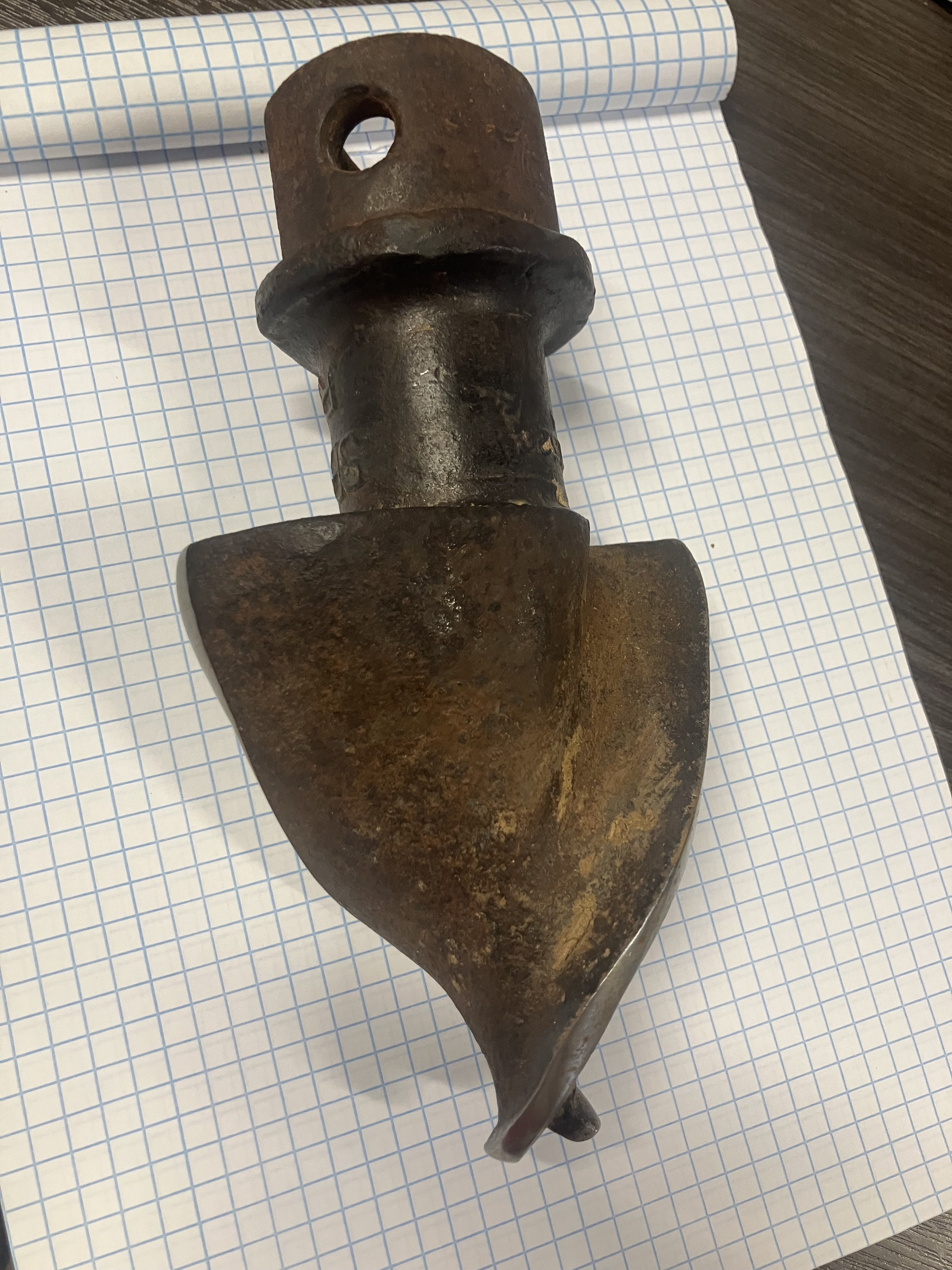

I have a Rhino L200 9” PHD and it has stopped digging. I want to swap out the dull tip. I see 2 options: spiral point and fishtail. My soil turns to red clay at about 24 inches, rocks not a problem. Which point gives better results? Guadalupe County, Texas

No rocks equal a replaceable cutting edge versus a screw tip.
   / Auger tips #3
Having used both tips, I prefer the fish tail type for our clay soil.
Sharpening or reversing the auger bits also makes a big difference.

Drilling too fast and getting stuck is a direct result of you not plunging down a bit and then pulling it up out of the hole and repeating. You always need to 'pump' a PHD up and down and pulling it allows the flights to expel the dirt and always dig at the lowest possible PTO speed as well.
