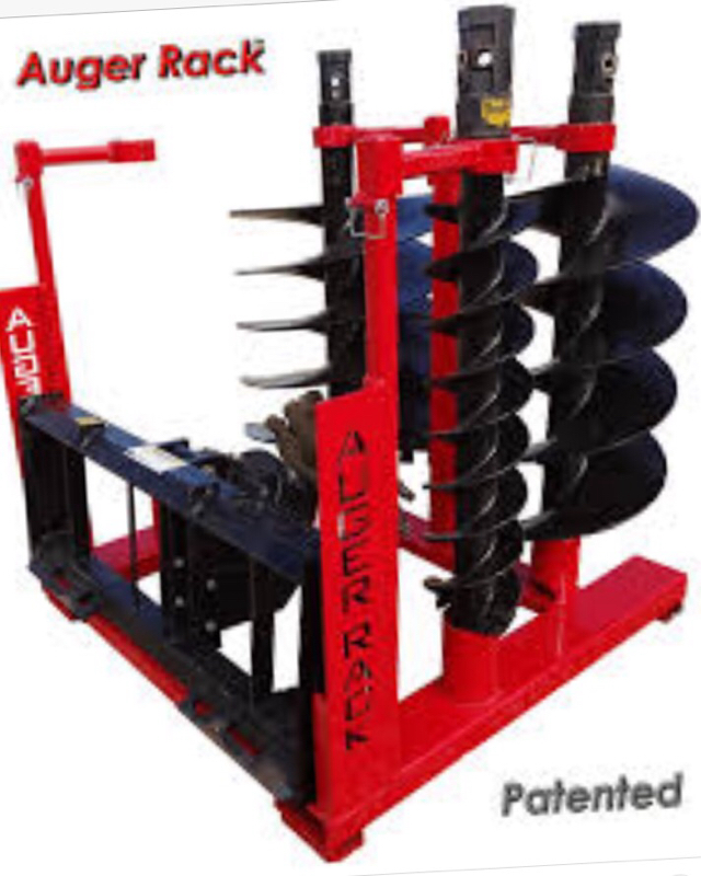

AnyOne built there own rack and storage system for a hydraulic SSQA auger drive and bits? Only thing I've come across is "Auger Rack" which is a really nice design, just curios if anyone has come up with anything different.

Thanks, I'm looking to keep the augers up right, so I can change out the augers with out having to Handle a 150 lbs auger alone. :) I'm probably going to end up building something very similar to the pic I guess, I like the idea of being able to move the whole setup around or set on a trailer or in a truck if I need to transport it.

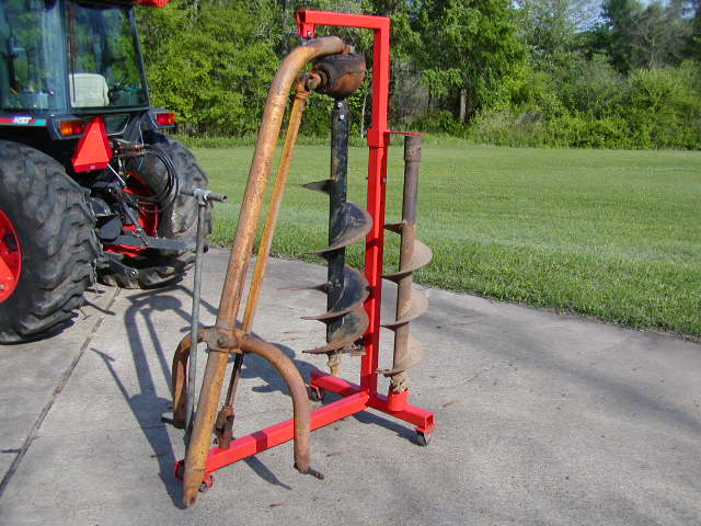

We only have 2 augers. We store the spare on the post hold digger stand. Both the top latch for the auger and the top for the digger rack are gravity fed for ease of operation. The tongue to move the stand around in the barn will slide up into the lower square tube for storage or for hooking up to the tractor.

Finally got a stand built , think it will work ok.
