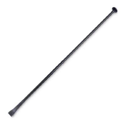

Speed being the issue the tractor does seem faster but I really don't think so in most cases. I know I got pretty fast using these and one without the other is not good.
View attachment 205107 View attachment 205108
We using those as well as hedge clippers to cut small-medium roots near the surface, and:
Fiskars Pruning Stik to cut small-medium roots further down in the hole:
A sharpened chopping scraper to cut bigger roots anywhere in the hole:
... and anything else we can come up with to make the job (seem) easier (kitchen sink?) :laughing:
