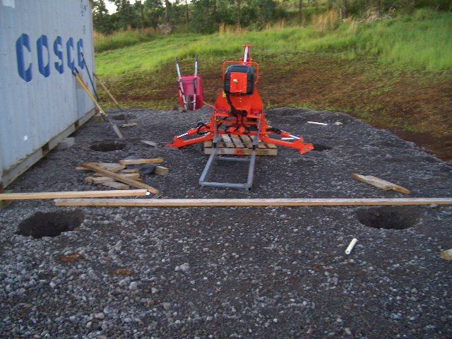

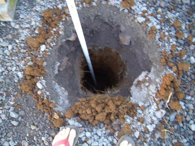

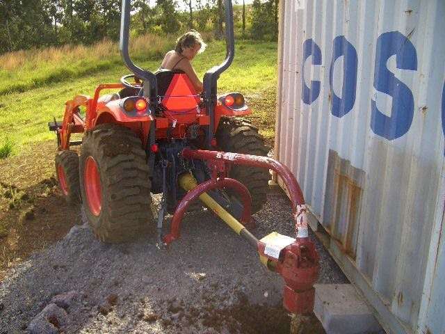

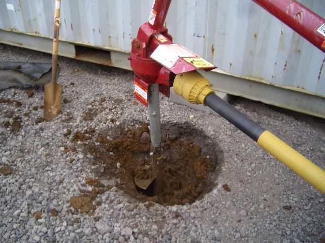

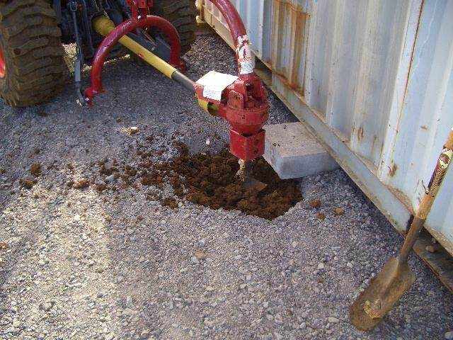

I have to sink nine 4in pipes 56 inches deep in 12 inch holes as supports for my tractor/utility shed. Requirement is 1/2 the above ground height has to be in the ground (112 / 2 = 56). These are 12in diameter holes and will be filled with concrete. My 12in auger for 3pt phd is only 45 inches, 2inch shaft. Is there such a thing as an extension available? Perhaps a home-made solution? I anticipate fairly easy digging as I've hand dug about 20 holes to the 3 ft level by hand about 300 away and figure similar conditions. Guess I could get the last 11 inches by hand /forums/images/graemlins/frown.gif, but prefer not to.
