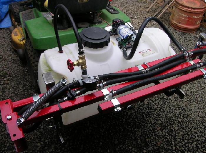

BTW, Gary Fowler has it right - oversize your pump and add a recirc line - if you tee in a gauge right at the boom and a valve going back to tank return, you can put your water in the tank first, adjust the tank return valve for the pressure you want at the boom, then valve off the boom itself, add your chemicals, let them mix a while (this method also eliminates the foaming you get with some chemicals while filling with a hose)
Here's a pic of mine after I upsized the pump (also dead like yours) and added a boom. In the pic, the pump outlet isn't hooked up yet but connects to the dual valve hose wye (green) - note that the return line gauge/valve go direct to tank, and if you look closely you can see small black inline valves (2) that shut off the nozzles so you can mix with the pump... Steve
