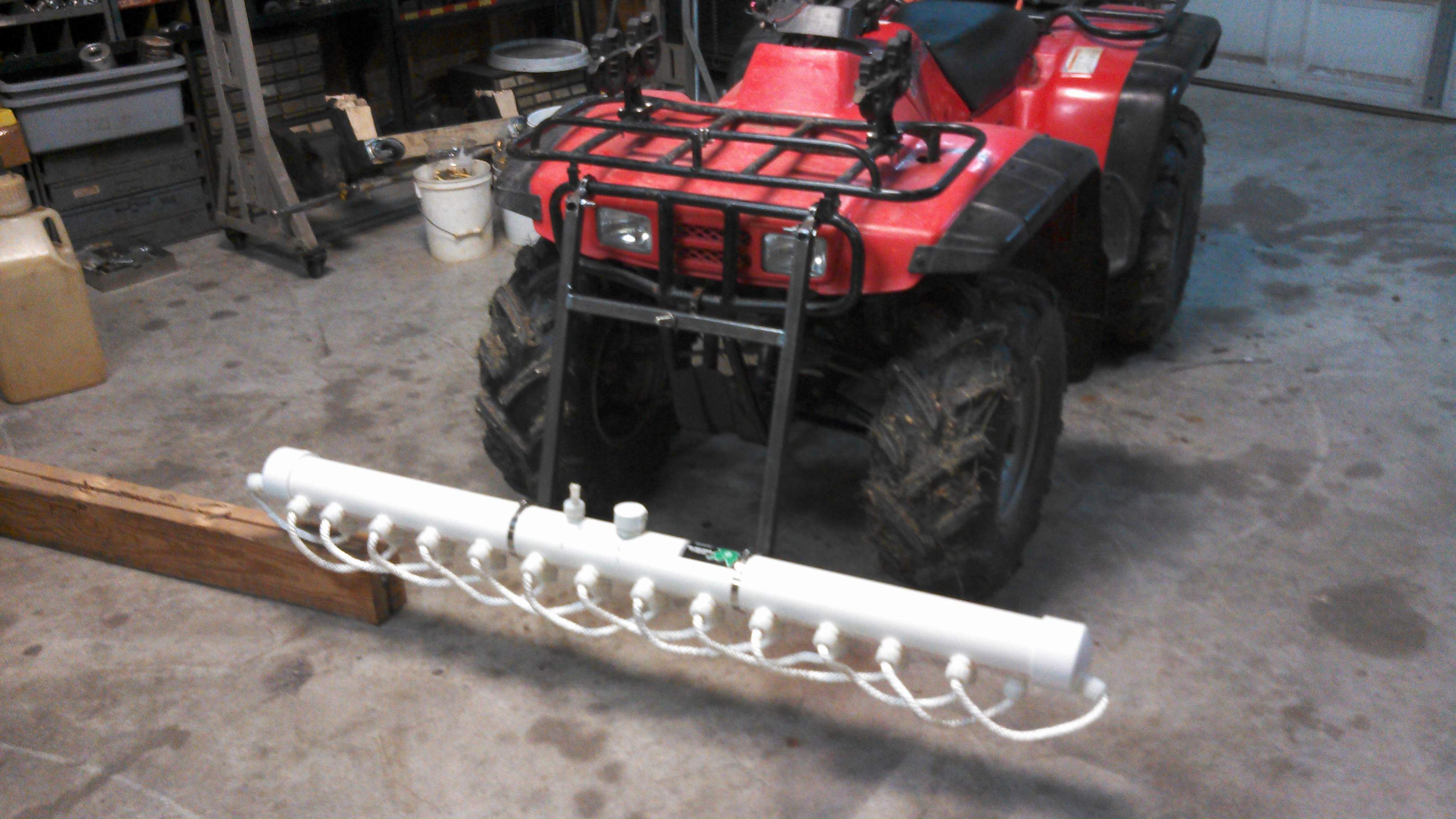

Spring is here and the weeds are in full force. After a day of spot spraying and a round of broadcast spraying weedmaster, I decided I needed a different method. After a little research I went with a rope wick applicator using round up to speed up the process and get other undesirable plants.

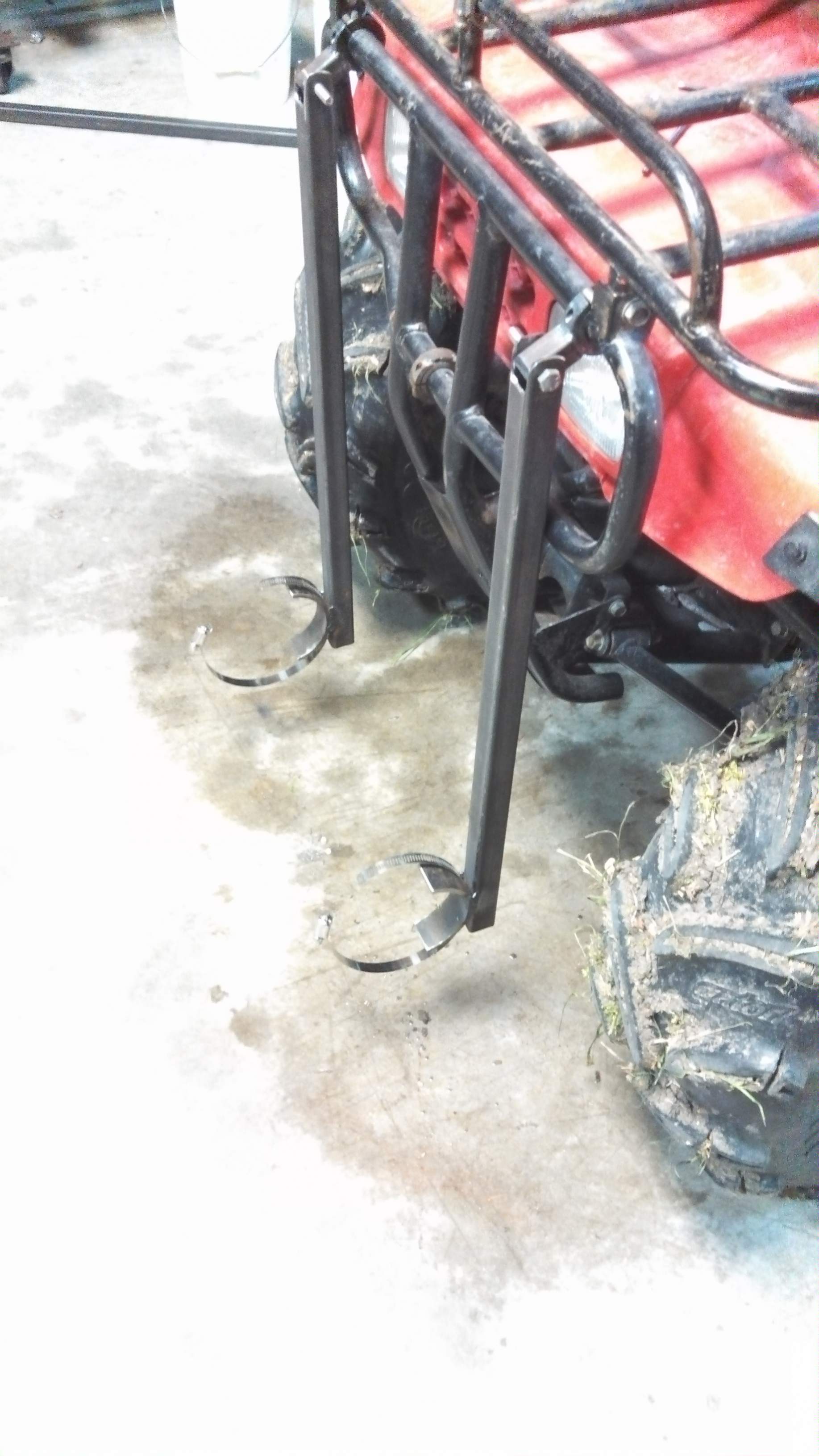

Looked at building the applicator as its pretty simple but they can be had cheap enough, so I just bought one. The mount on the other hand seemed a bit pricey at over $300. So I made this one that uses double split set collars to mount it to the factory brackets.
The 1/2" all thread in the center it to adjust the height.

Were did you get the wick applicator and price if you don't mind? Nice job on the mount! Thanks.
Dave
   / ATV Rope wick mount
Ordered it from menards. Its a green leaf product and cost $137. You could buy the parts to build it for $80 or less if you already had the drills and taps but figured my time was better spent on the mount.

Thanks,that's not a bad price.

Well, went over 5 acres around the house, now the wait to see the results.

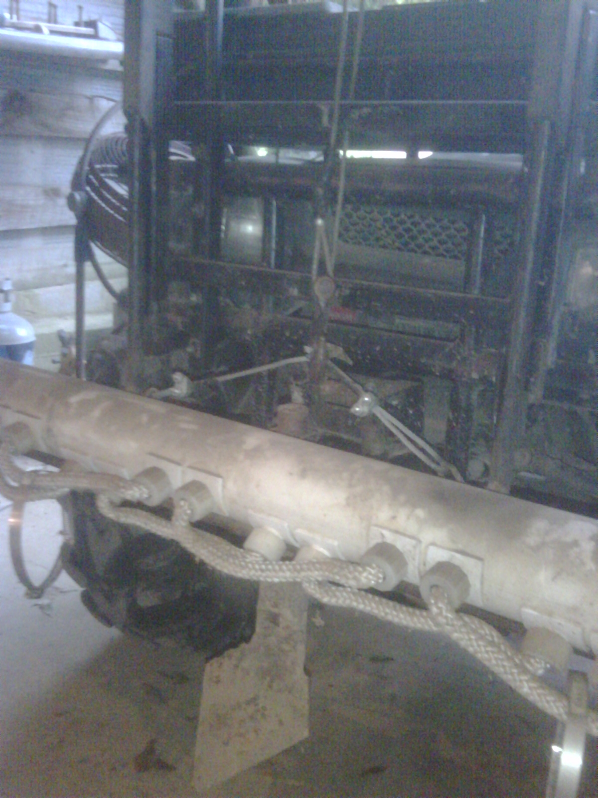

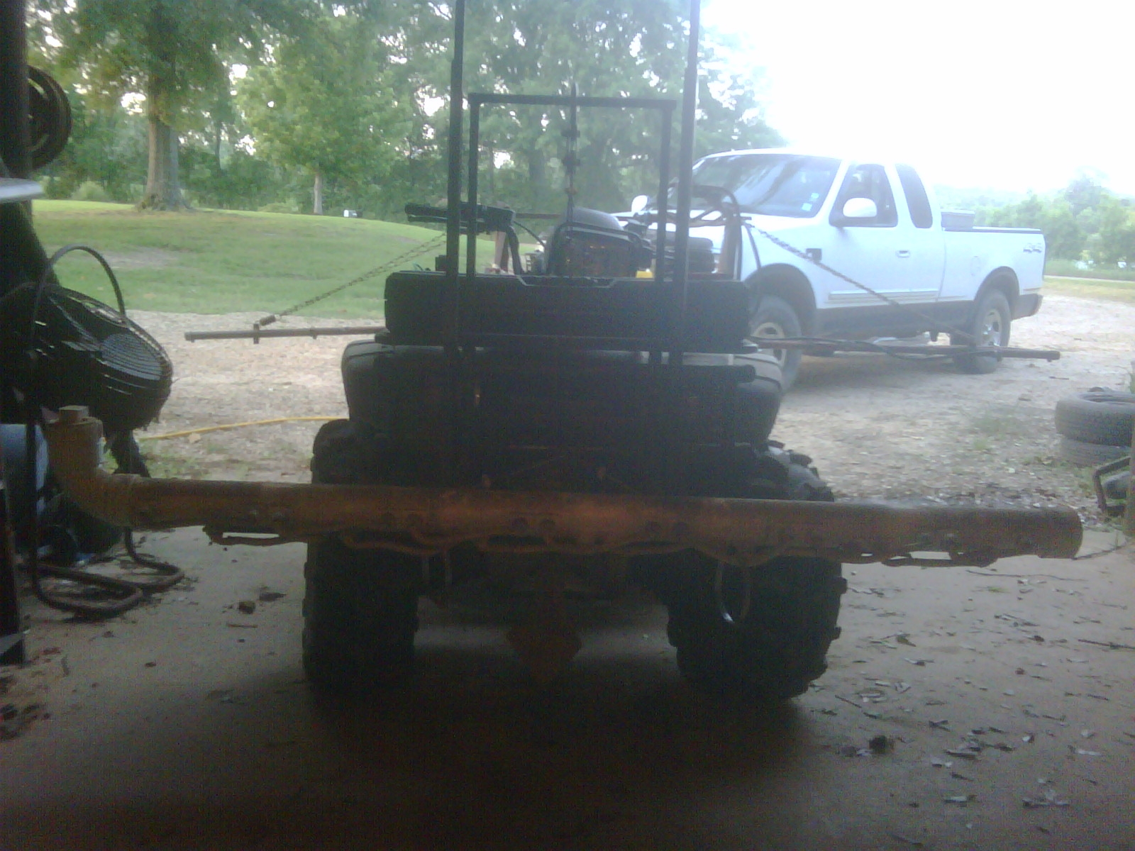

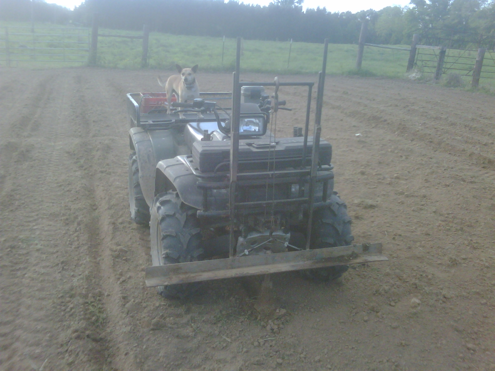

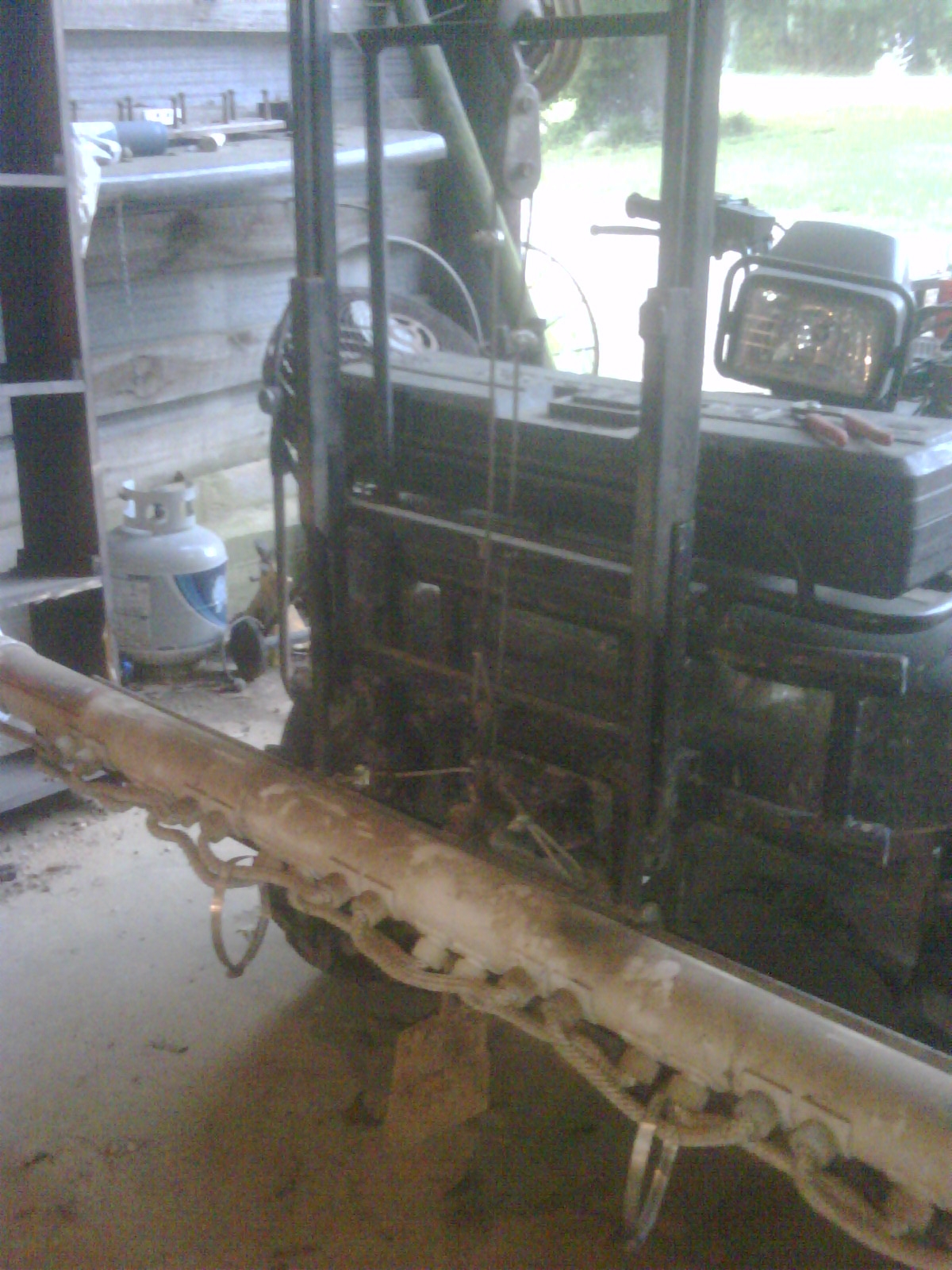

I built my own mount. I control the up and down with the winch. I also use the same mount with wick removed and a plow point added to make my rows in my garden.Wick Plow 4.JPGWick Plow 5.JPGWick Plow1.JPGWick Plow3.JPG
