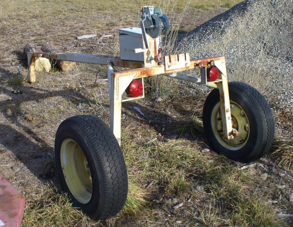

Here's something I put together some years ago (1980's) after seeing an article in Mother Earth News. I used a boat winch and wheel hubs & tires I found at the local wrecking yard. A spare ammo can came in handy for storing chains and other accessories. I even fancied it up with some running lights I had lying around.
To haul a log you positioned the tongue at one end of the log, wrapped a chain around it, then winched up the other end using the boat winch. The tongue was also adjustable for different length logs to keep the center of gravity where it should be.
It worked pretty well to haul individual logs around without having to drag them through the dirt and risk damaging the surrounding landscaping.
I haven't had a use for it since - so now it sits and gathers dust/rust.
This was before the internet but I see there is a link now to that original article.

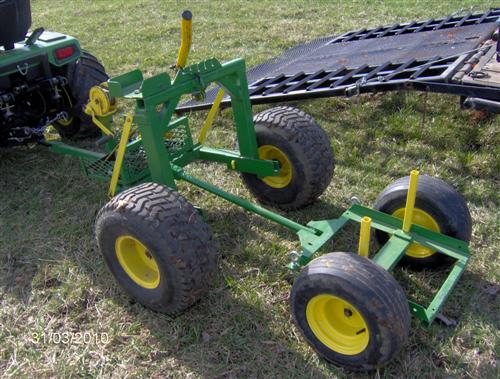

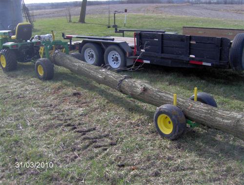

I made my own log arch from old garden tractor wheels & scrap I had on hand. Just don't use the tail cart on steep slopes! ~~ grnspot
