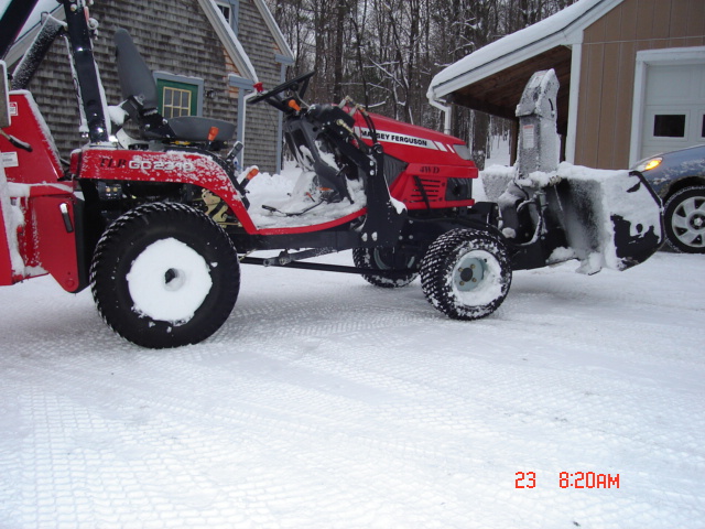

You WILL enjoy that front-mount set-up, in spite of its complexity. That was the main reason I got my SCUT a few years ago, for the front-mount blower. Works fantastically well, especially compared to a walk-behind!:thumbsup:
