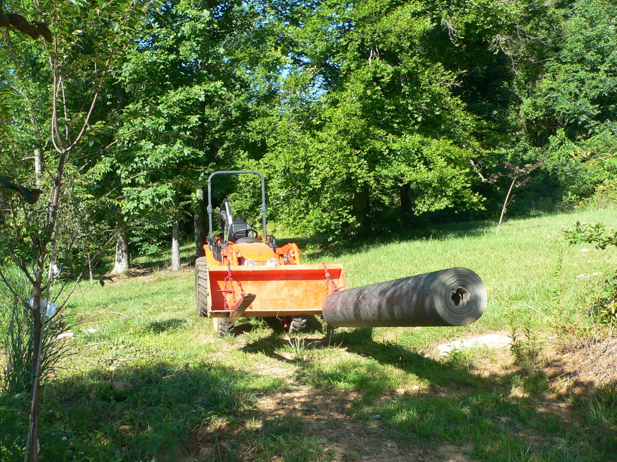

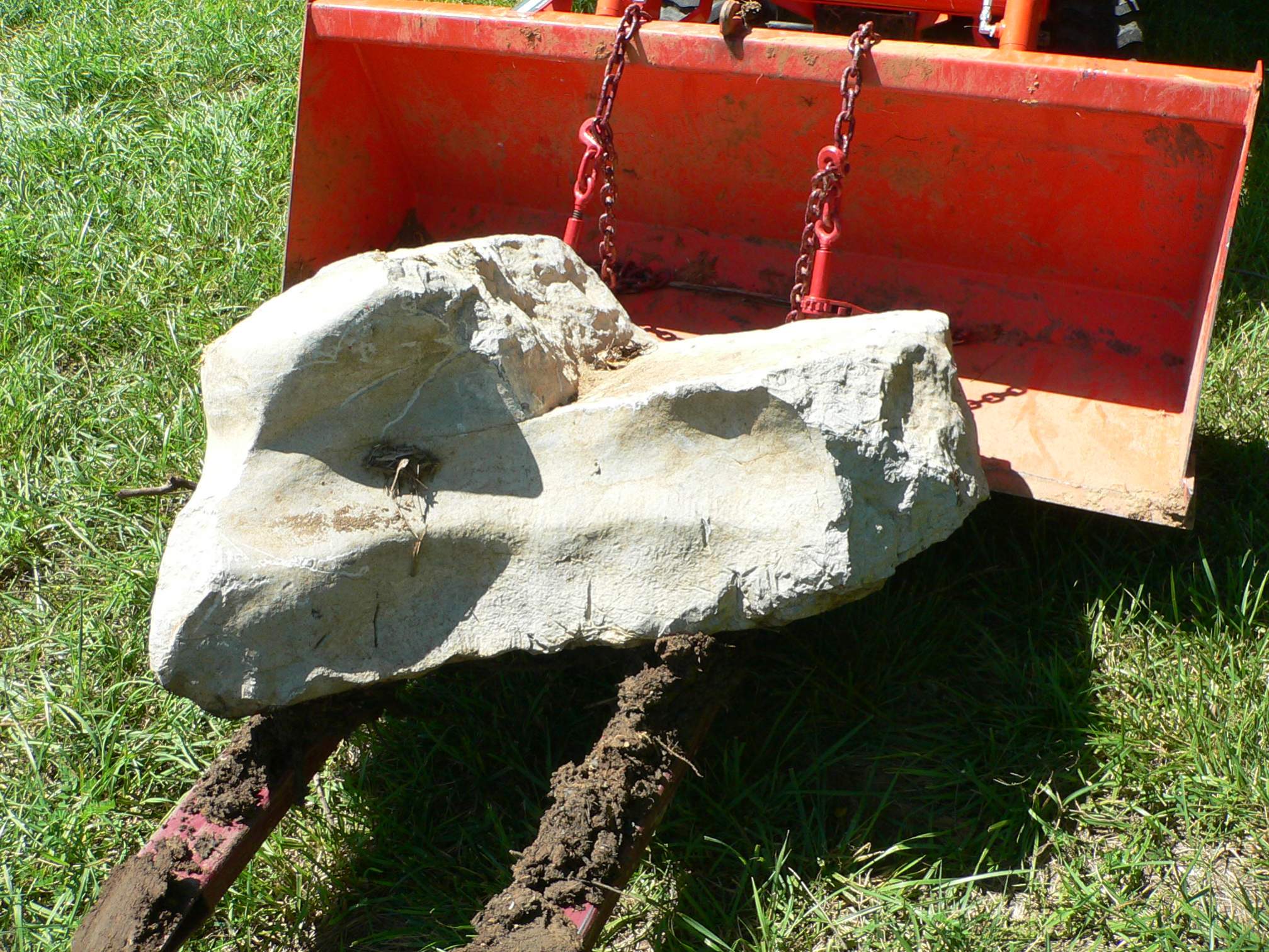

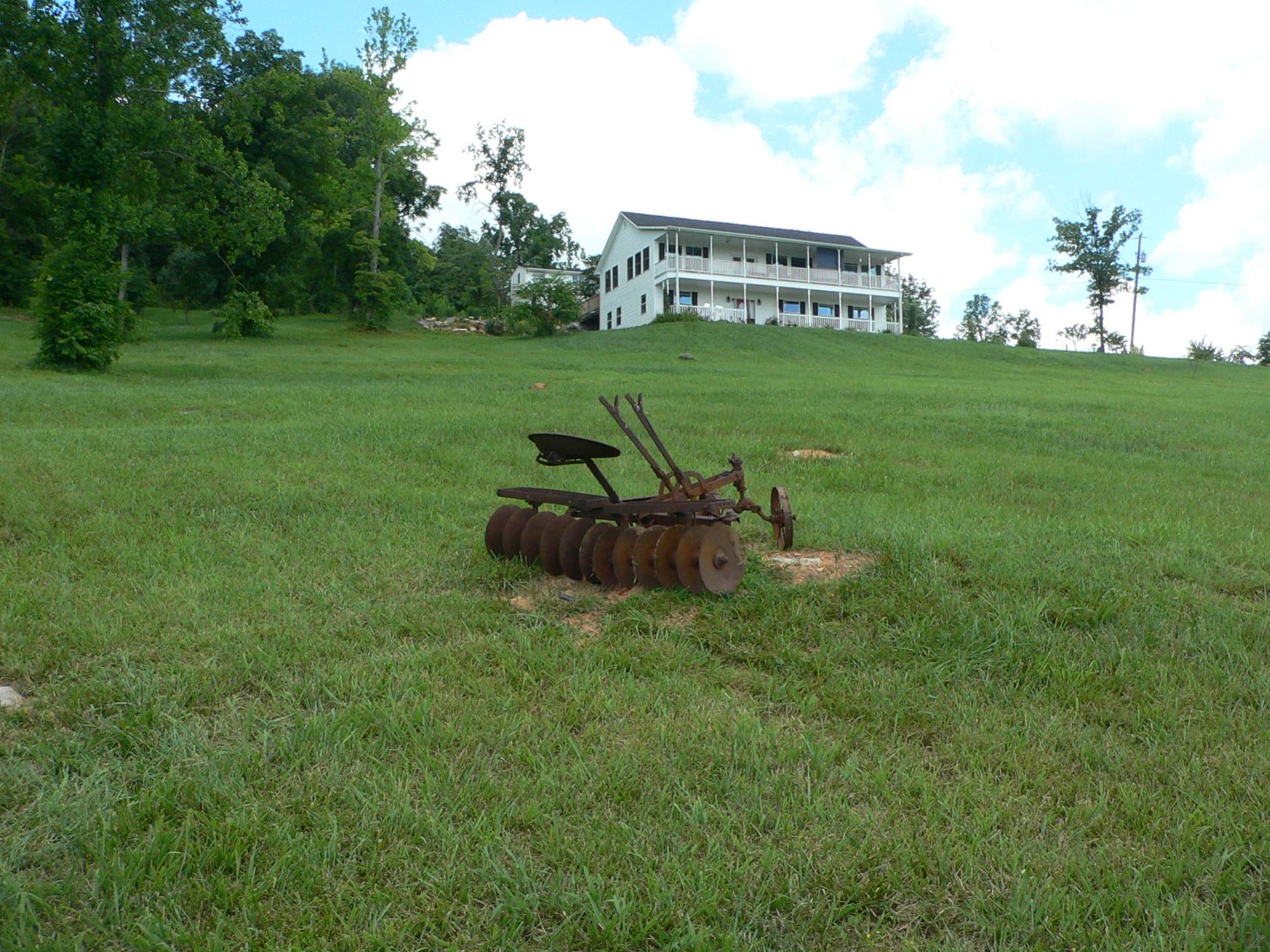

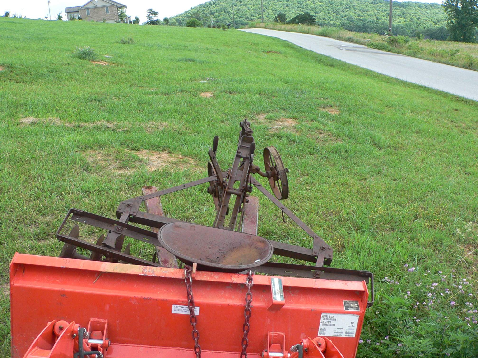

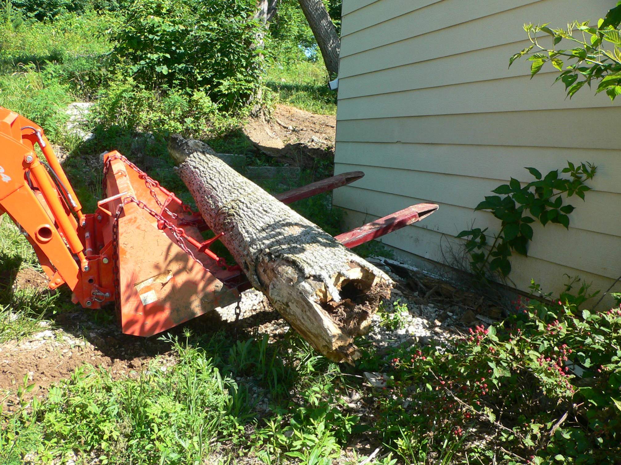

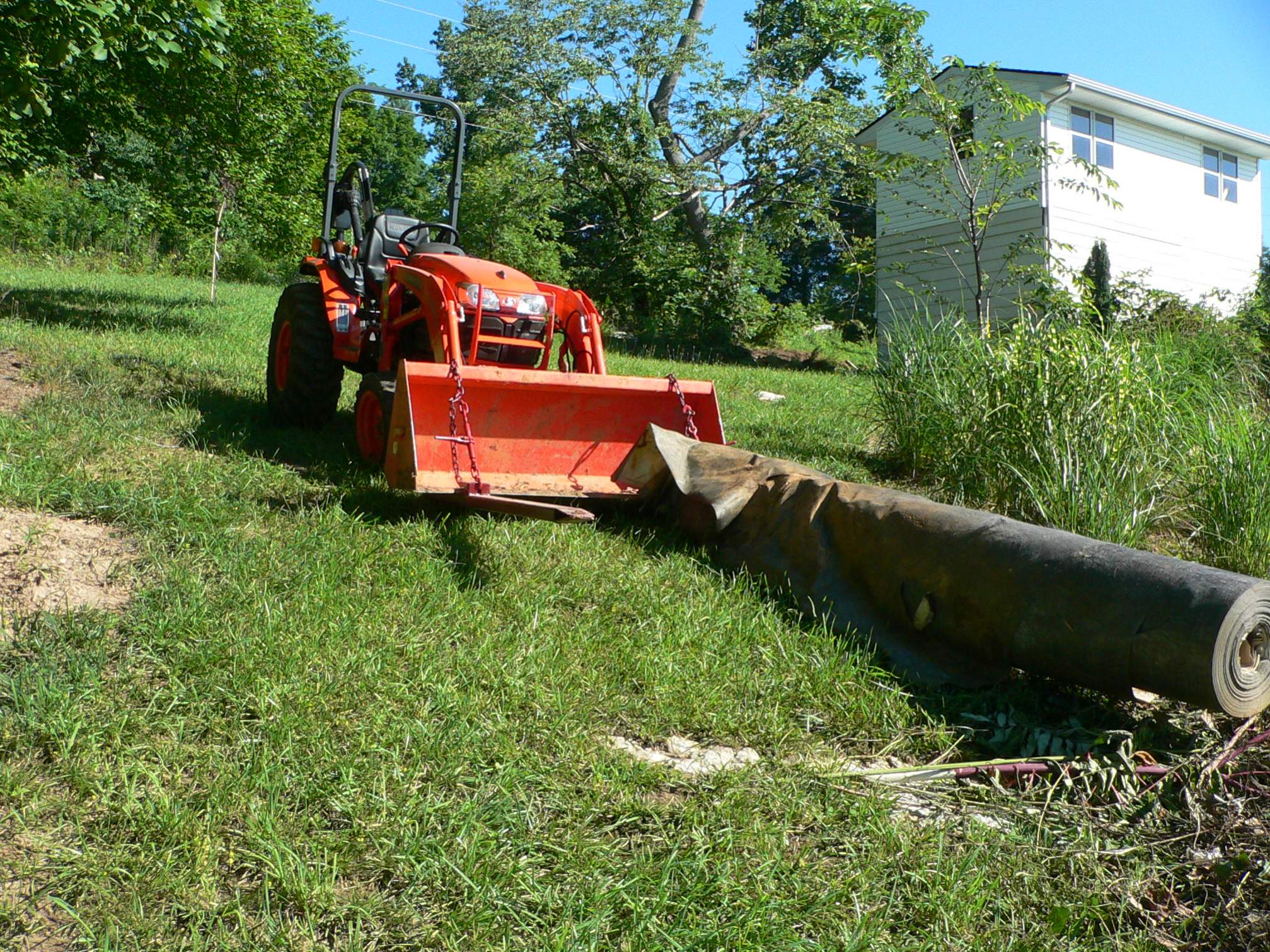

I don't know anything about the 3pt carry all but I have the chain on front forks. They are very handy. Guess there are plus's and minus's for either. I prefer looking ahead as I pick stuff up and seeing it in front of me. Also if you want to lift some thing off the back of a truck then only the forks would work. I believe the height lifting, looking forward instead of backwards plus tilt would push me to forks which is the choice I made. Here are a few pictures of uses for front forks. They are one of the handiest all around implements I own.
