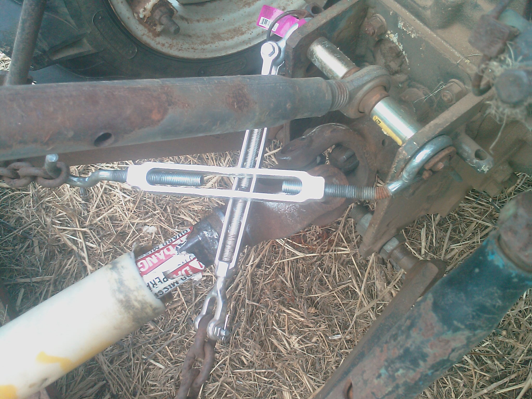

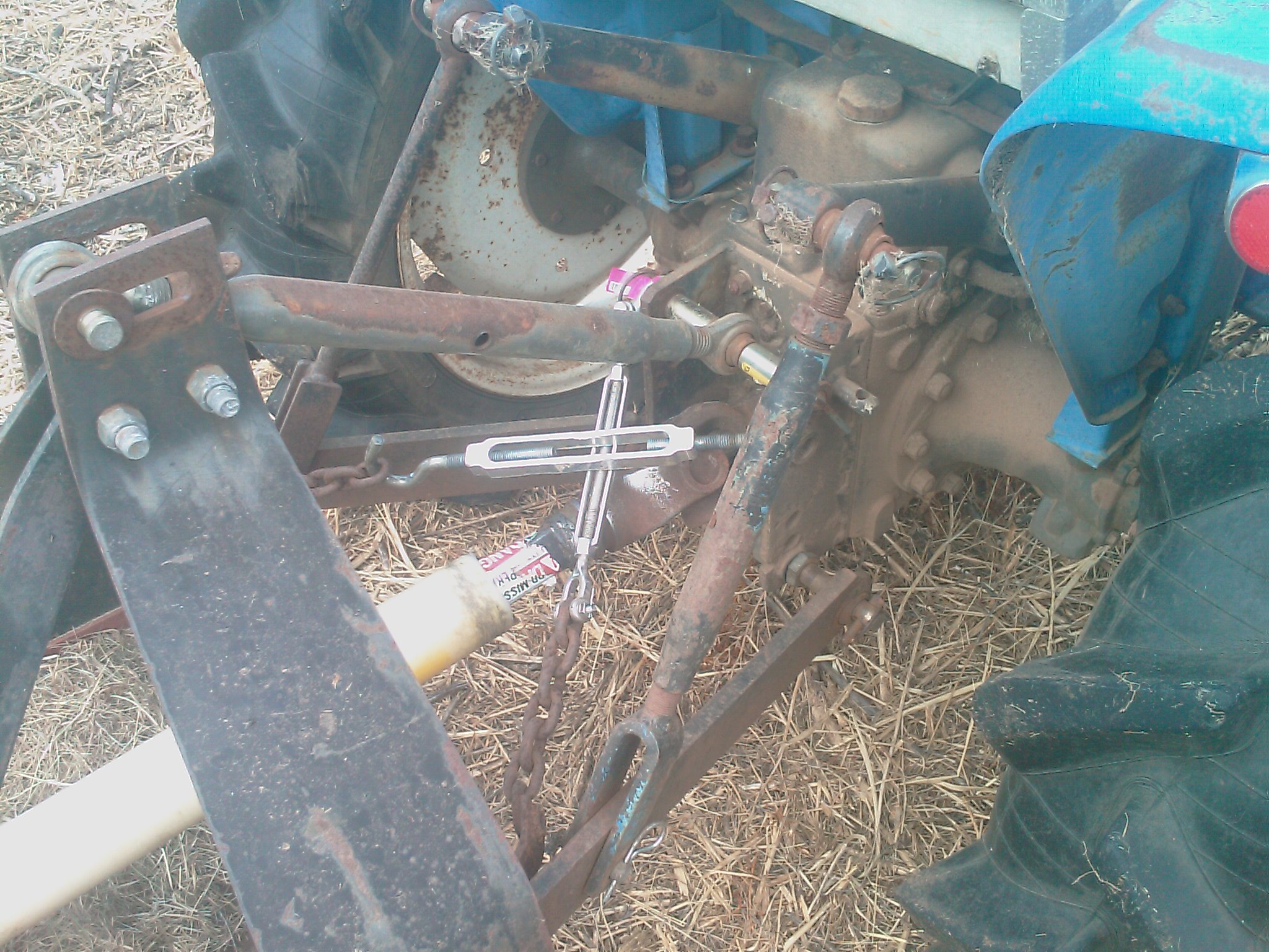

I have a Howes 400 mower attached to my TS1610; it's attached pretty much how I bought it. I am completely new to tractors, so I don't know all the terms; but there are two turn buckles attached to the bar at the tractor where a large single "turnbuckle" is installed and connected to the highest point on the mower, and the two turnbuckles then cross each other and are connected by fabricated chain and piece of metal to lower bolts (where some braces are attached).
My question is this, since I lost one of the turnbuckles that came with the tractor, I replaced it. But do the turnbuckles have to be crossed? or can the be attached left to left and right to right from the tractor to the mower deck?

/ Attaching a brush/mower - TS1610 #2
Looks to Me like its not hooked up right at all or Mine aren,t. Mine has the chain go straight across & the turn buckles are on the outside running straight of the lower arms .
Main reason is to Hold it from going side to side to keep clearence from the tires , At least thats the way it is on mine . But Mines a different model . Heres a few pics . I hope You can see them good enough. Bob
the side edges dig in to the ground if I am missing one of those, I think they are mainly to keep the front edge up with the rest of the mower. This is basically how I got the tractor and other than the crossed turnbuckles confusing me, it has done a really good job so far. I just need a bit of weight for the front as the tractor likes to do wheelies in medium/3 with that particular mower hooked up.
If the unit is completely hooked up wrong, I guess I should figure how how to hook it up right. But the mower may require the extra turnbuckles to keep it level.

Desfaust,
Your setup is not correct. You should have turnbuckles on the outside of the lift arms that connected to attachment points just under and behind the fender mounts. These attachment points are in line with the front pivot points of the lift arms so everything stays snug whether the lift arms are up or down. The turnbuckles keep the hitch from swinging side to side.
The cross chains in cowboy357's photos are also not used. My cross chains are just hooked along the insides of the lift arms and not used.
You setup looks like the turnbuckles will go slack when the mower is raised. This could be a problem if they contact the PTO.
Your tractor should not do wheel stands. My Howes 400 mower has a tail wheel that prevents this. Moreover I can raise the mower completely off the ground behind my TS1610 and drive around with no wheel stands. The tail wheel also sets the cutting height and allows the mower to track uneven ground. When you are mowing the 3 point lift is not carrying much of the weight of the mower because when it is lowered the tail wheel carries much of the load.
If you are missing mower parts, you can go onto the Howes web site and download an owner's/parts manual to see what is missing.

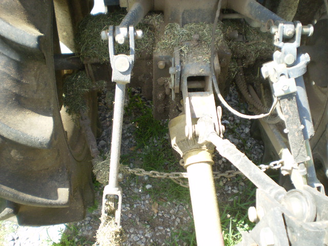

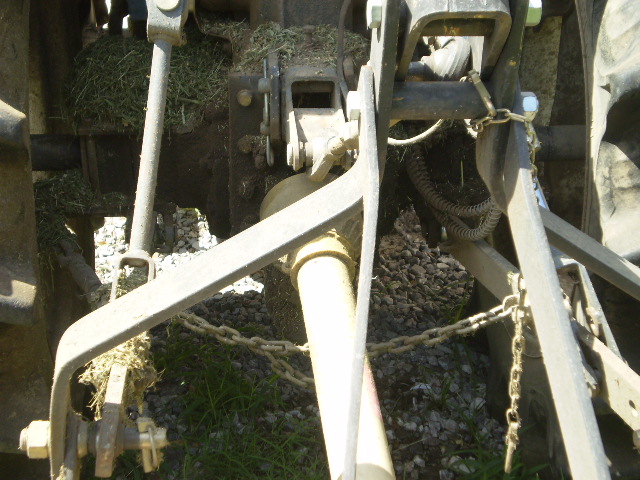

Here's a couple photos that show what mine looks like with a tiller on the back, hopefully you can see the sway control chains. I'm pretty sure it's all stock configuration. Even with the heavier 4x4 axle/diff. up front, mine gets light with the tiller up in the air. I do have the tiller set back away from the tractor further than stock however due to the 2-pt to 3-pt adapter that's in place.

I gotcha Jim thanks for the explanation.
larso1 , That tractors entirelly to clean. :D . Thanks for the pics. Bob

Dasfaust,
I took another look at your photos. I think someone has not connected your lift arms correctly. The front pivot points should be under the rear axle, not on the framework that surrounds the PTO. If you look at the photo I posted the front arm pivots are on brackets that share mounting bolts with the fenders. It looks like your setup places the implement about 6" back from where it should be. No wonder the front end comes off the ground. In addition the lifting arms (I'm running out of terms) should be attached near the rear of the lift arms. It looks like yours are attached to the center bolt holes where the turnbuckle attaches. You must have a strong hydraulic system to be able to lift the brush cutter, because you are at a great mechanical disadvantage.

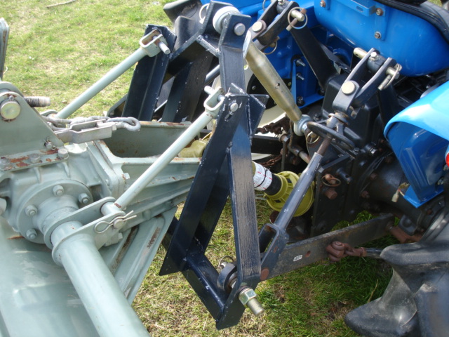

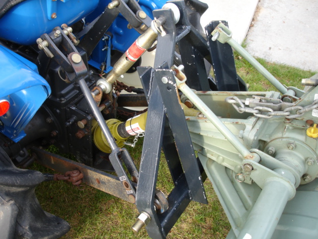

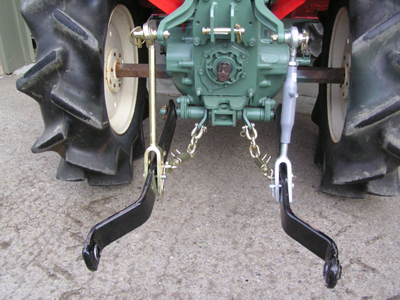

Instructions are provided for the correct hook up. This is for a Yanmar, but description and layout is the same.
Yanmar Tractor three point kit
Another version.
