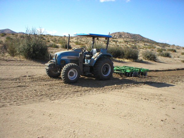

I looked at a set of old Athens offset harrows this weekend. They was the pull type. I have a MX5100, 4x4, R4 tires (loaded), and front end loader attached. This harrow is 7.5' wide. Looks to be really heavy. Would my tractor be enough to pull this harrow? I felt like it was a good deal @ $1500 because it was in good shape. How big of a pull type harrow would I be able to pull with my tractor? The guy selling it said he felt like my tractor would pull it. (keep in mind he's selling it). From what I can gather from the internet these harrows will weigh around 3k lbs. He said if it struggled with it I could just adjust the gangs to be less aggressive. Would this be the thing to do? or would I be better off just looking for something smaller? Will it hurt my tractor if I pull a disc harrow that puts my tractor to the max?

There are variables that only you know about.
Type of ground, & flat or rolling hills?
Do you want to just go over the ground once each year, or more often.
Do you want to turn the ground axle deep?
Weed control, fire break, or planting for a crop?

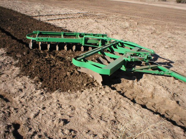

Yes you can adjust the axle angles so that your tractor will handle the disk, but that typically means that you need to go more passes to get the desired results.
Again, only you can actually say.
I have an old Keilfer (JD) set of pull disks, actually 3 sets, 6', 8' & 12', all with 22" scalloped pans. With my 75hp, 10,000lb tractor going up hill pulling the 8' set, it is all the tractor wants pulling axle deep.

Pulling that size disk harrow should not hurt your tractor. Just don't lug the engine. The ?? becomes - does your tractor have sufficient traction to pull it.
If you keep the tractor in a low enough gear to not lug the engine - what may happen is you will loose traction and all four wheels will start to spin.
You could find that to till to the depth you want - you might have to adjust the gangs and go over any area multiple times.
As long as the engine is not being lugged - the tractor is being operated in the manner it is intended.
My tractor, which is only slightly larger than yours, is designed to pull a "pull type" disk harrow up to 108" wide.
The one you are looking at is 90" wide.

Working the machine to it's max is fine and you can do that all day long, that's how they are made. You just don't want to be constantly lugging the engine. Just need to find the right gear, or pedal spot for the conditions that you are currently working. My tractor pulls the 8' disk without even knowing it's back there until I turn and go uphill, then I have to drop a gear and the temp gauge starts going up if I'm on my 2nd pass.
I run my disks at maximum angle, you can always adjust that down some and you should be fine. Price is right if they are in good shape. I had to rebuild mine. The purchase price was low though, otherwise would have had to keep looking.

You may be able to pull that disk easily depending on your soil type. If the going gets too hard like in soft damp soil, simply use the wheels on the implement to raise the disk up a bit. HP wise you should be ok for an 8 foot disk but unless you have plenty of wheel ballast, you may run out of traction. Just try it if you can and see how it works. If the farmer has that disk, then he must have some place that you can use it on prior to buying it.
Realize that most instances, you don't need to pull a disk 10-11" deep to get satisfactory crop results, 5-6" is usually enough to uproot any vegetation growing there. If you need to break up a hard pan crust, then use a subsoiler or chisel plow.
