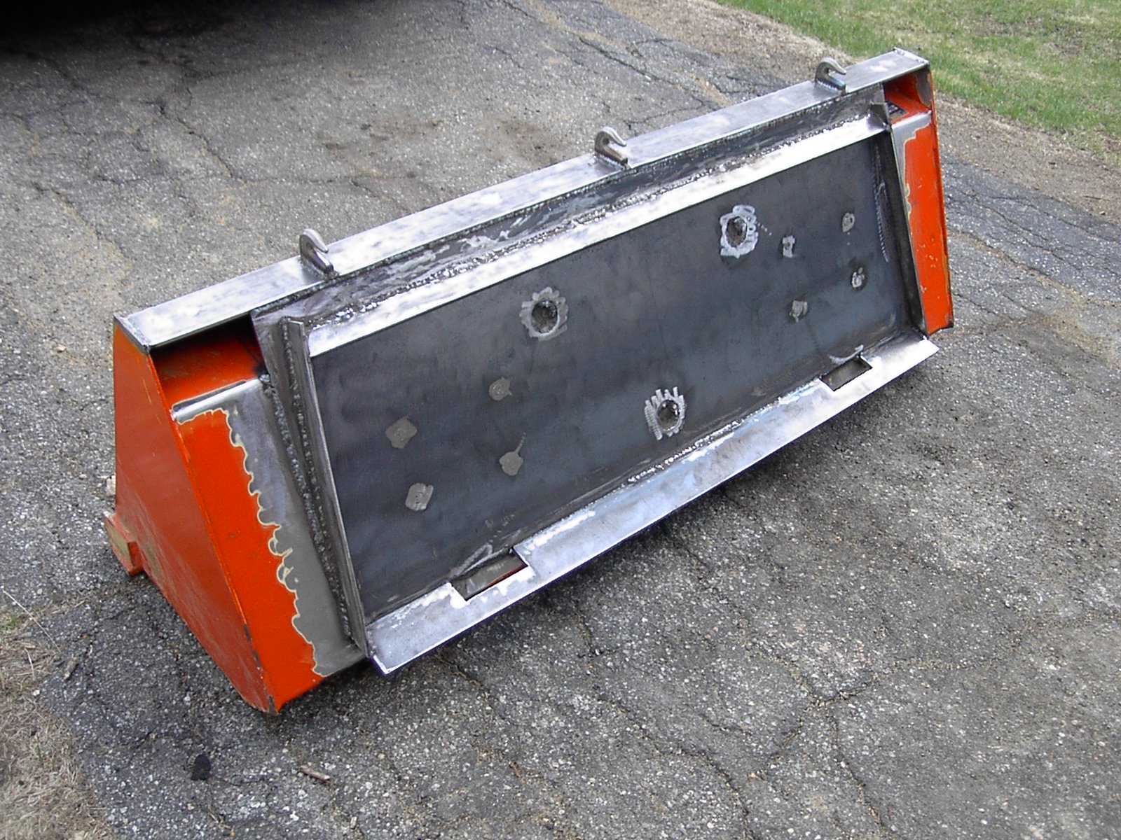

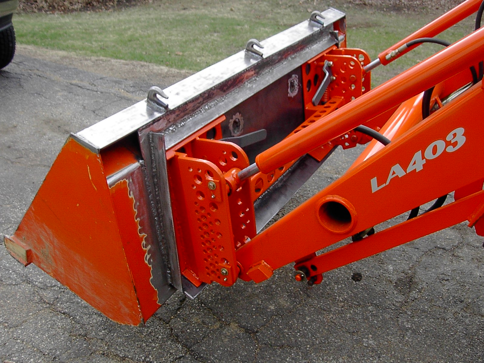

JJZ..... i converted mine to SSQA awhile also. Do you weld at all? I ended up paying a local shop to cut my factory brackets off of my stock bucket (versus me fighting with them), and i scratch built the SS style mount for the back of the bucket. The most economical way is to buy the SSQA bracket(s) off of Ebay though..... usually around $100 +shipping. Though you can certainly use a skidsteer bucket, the problem is they are much deeper than your tractor bucket..... bringing the leverage factor back into it. And.... they are usually a little shorter on the back, leaving less spill protection (onto your hood). Not to mention the added weight of skidsteer buckets, because they are thicker. I do see a few used skidsteer buckets on CL for sale..... though most of them are pretty beat.
My free advice is....... dont bother keeping your original bucket intact so you can switch back some day. Once you see how quick and easy it is to swap from bucket to forks to whatever other front attachments you have, you will NEVER think about switching back to that pin on bucket !!

P.S. Adding the SSQA to my loader was definitely the single best modification I've ever done to my tractor. I gay-ron-tee you will wish you had done it sooner ! :thumbsup:

All I've got is a little 120 volt wire feed welder, and I'm not yet proficient enough with it to tackle such a job. So the added expense of having a shop do it would be factored into my situation.
Maybe it's just the appearance, but your bucket looks massively heavy with that plate work on it. How much did it increase your weight?
