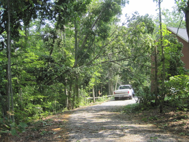

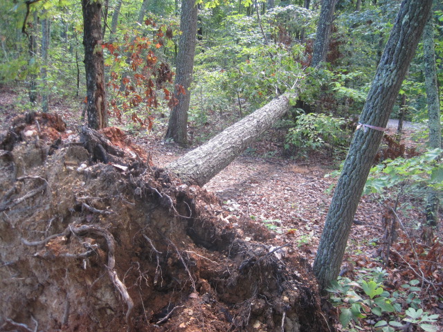

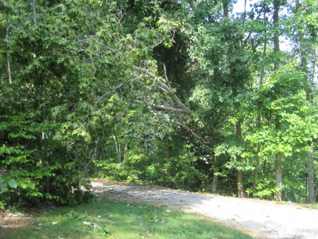

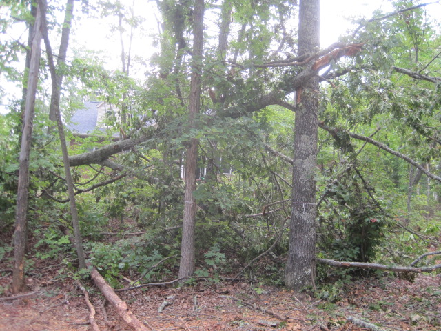

Now that I can post pictures, continuing where I left off...
I removed what limbs I safely could from the top of the leaning tree.
View attachment 441166 View attachment 441167 View attachment 441168

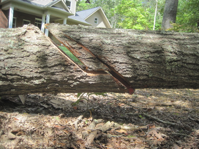

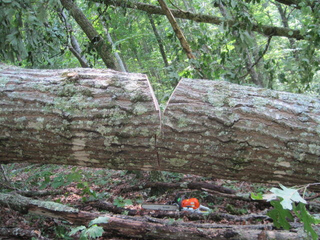

I then tried to cut the trunk about 10 feet from the root ball thinking the tree would fall to the ground. Nothing doing. The angular force of the top of the tree just pushed the two pieces of the trunk together. In fact, the tree trunk started raising, not falling. Next step - go watch youtube to get some instruction on how to bring down a tree leaning against another tree.
View attachment 441169 View attachment 441170 View attachment 441171 View attachment 441172
looks like it's bending up, so cutting from underneath would pinch the bar.
obed, Did you ever get that tree down?
Yes, I did get the tree down. It required cutting the leaning tree trunk at an angle so the tree could slide freely off the stump. I don't think I would have figured it out without youtube.

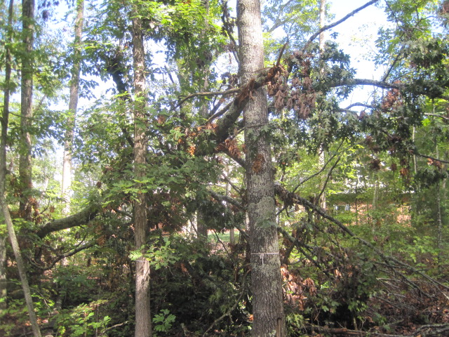

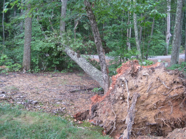

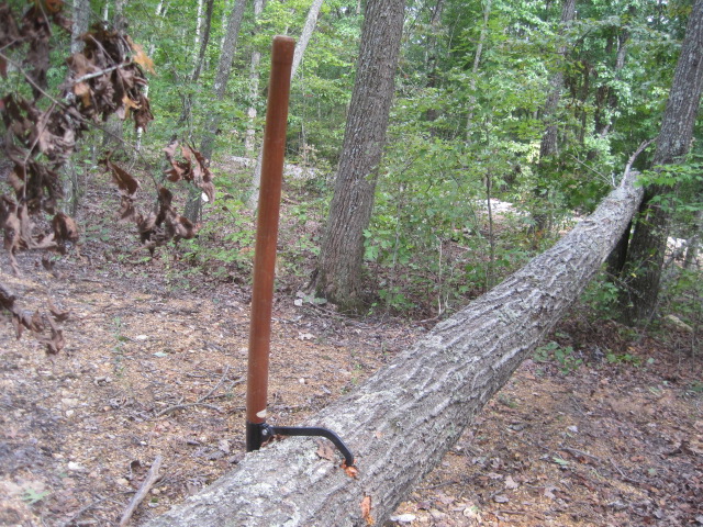

The same storm knocked down a tree at the edge of the front yard. Unfortunately, it was also leaning against another tree.

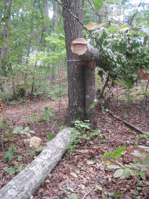

After cutting the trunk near the stump at an angle, this tree didn't fall. What I didn't realize was that the tree was lying on the tall stump of a smaller tree that the big tree had broken off.
I cleaned out the top of the tree before attempting to cut the trunk again.

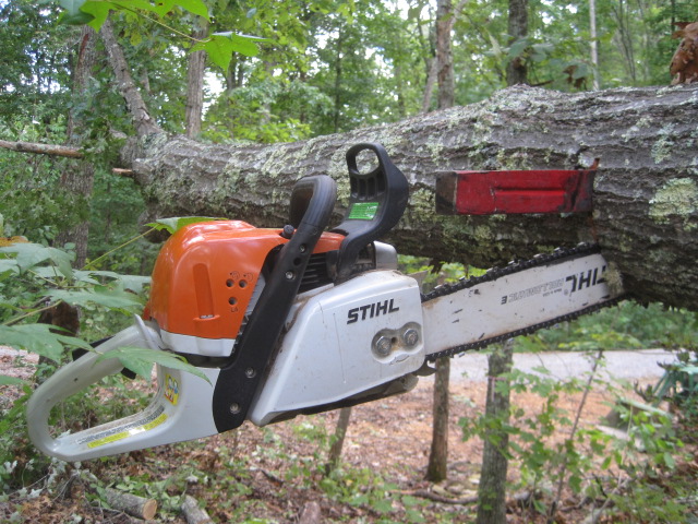

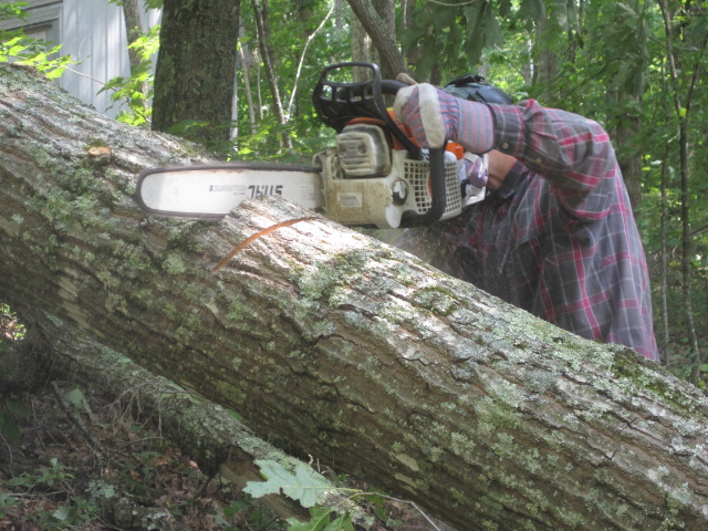

Then I got my saw stuck in the trunk!

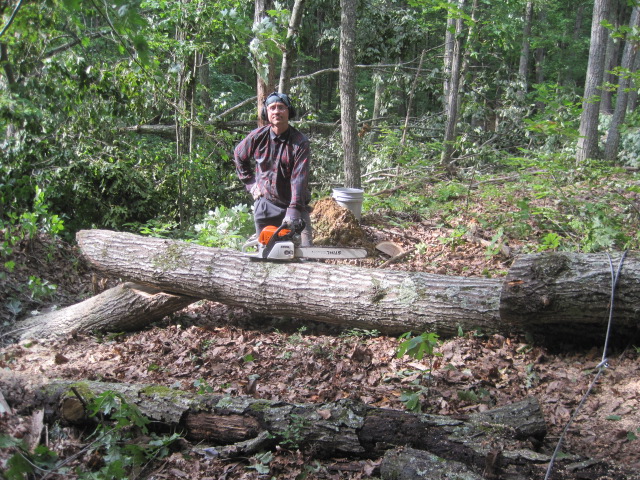

I removed the chainsaw engine from the bar, then finished the cut with my spare Poulan.

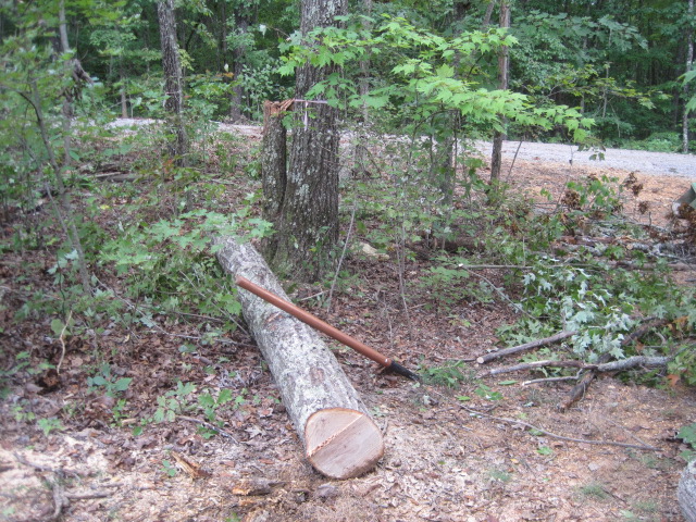

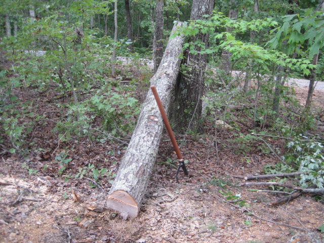

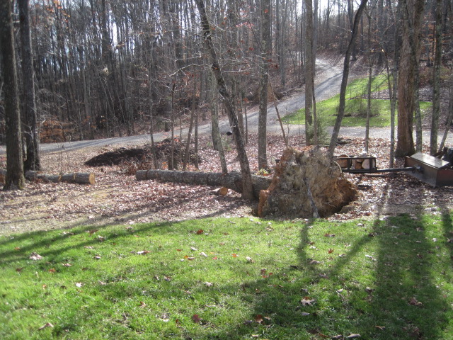

After topping the tree, the trunk still wouldn't roll of the tall stump so I made another cut to make the trunk pieces small enough I could maneuver.

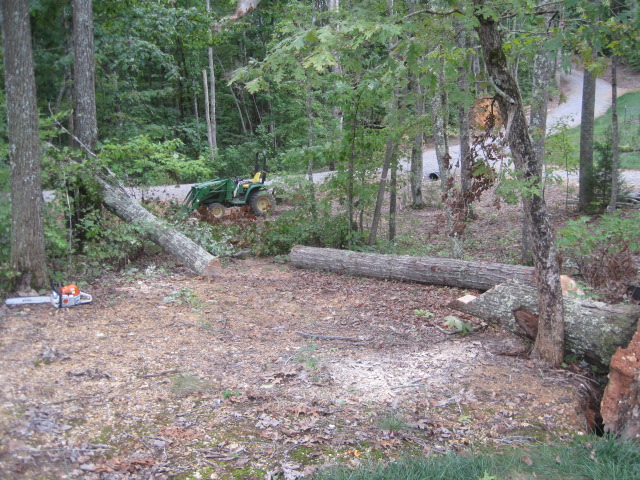

Finishing up.

Happy New Year. Good job on getting those trees cleaned up. You are getting more of a view than you counted on. But on the plus side, you will have lots of firewood. {Your helper is growing up}
Sometimes with a stuck saw, lifting the end of the log a couple of inches with your FEL will be enough to turn it loose.

Larro, Happy New Year to you too. I took my time cleaning up the second tree as there was nothing pressing me to get it done. No shortage of firewood, that's for sure. I did lift a log with the FEL last week to free up the saw. That log was lying completely on the ground and was easily accessible with the FEL.

Please do yourself and family a favor and get some safety equipment for all this saw work your doing.
At a minimum eye pro, gloves, helmet and a pair of chaps.
Object moved
I almost freaked out seeing you cut that trunk above chest height with your support hand no where near the chain brake., one kickback and that saw is coming right into your head and shoulder area.
That chain runs a mile a minute; google chainsaw injury pictures, one mistake can ruin all you've worked for
