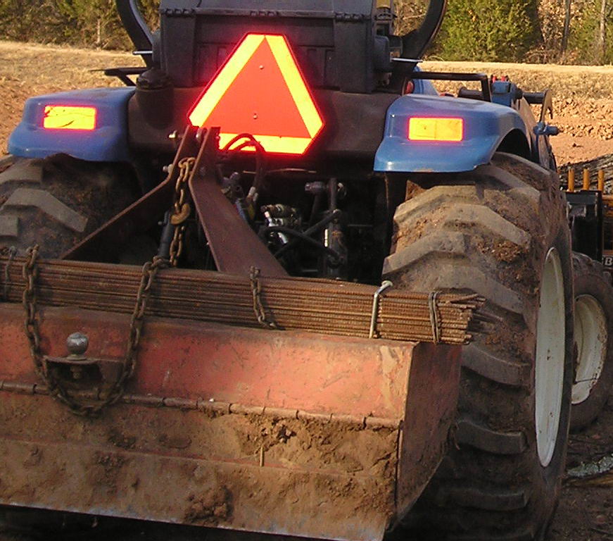

Jim, I like your box blade hitch ball. Do you have any pictures closer up? I'm trying to figure out how I will make mine.
Obed
This is about as close as I have currently. I didn't do the weld job myself. I bought this blade used and the hitch plate was already welded in place.
