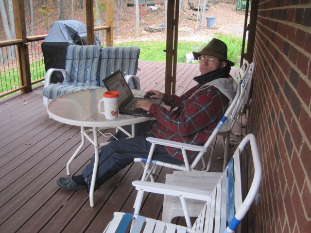

It's kind of sad. After we finished building the back porch, I was determined to spend some time on it. The combination of cool temps and a stiff breeze caused me to dress for the occasion. Underneath my coat, in the picture I am wearing a full-body snowmobile suit. I was quite comfortable and enjoyed the entire afternoon parked on my back porch. If you look closely, you can see TBN on the laptop screen.
   / At Home In The Woods #4,397
Now that is determination Obed...you are determined to enjoy that back porch...LOL...just wait until you get your screens in and spring and summer comes...you will spend a lot of memorable time out there...we do and we have a similar house and porch to yours....enjoy it...
