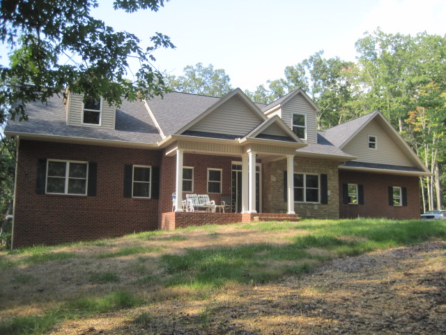

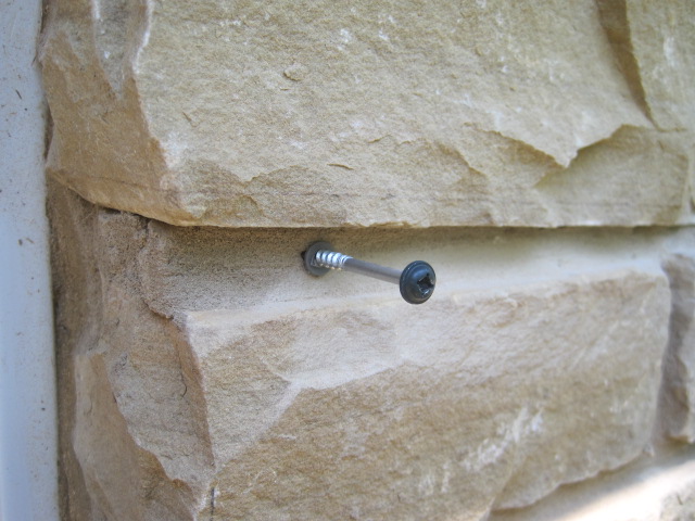

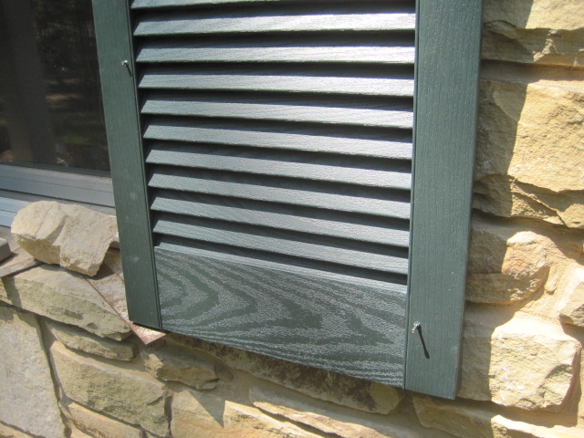

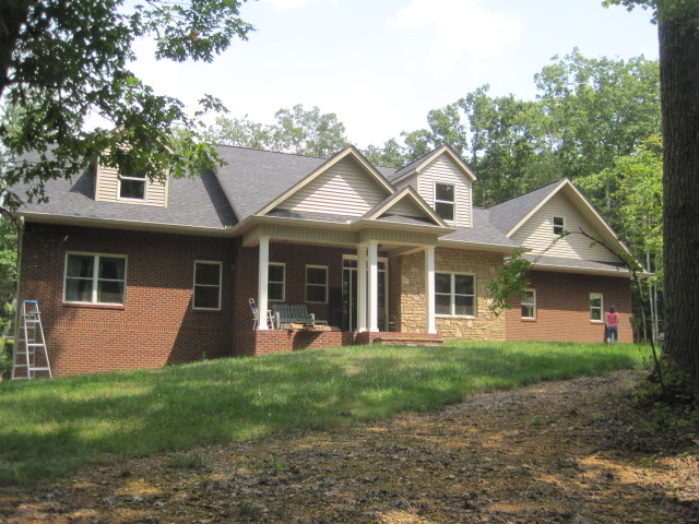

I finished installing the shutters. Installing the second set of dining room shutters on the stone went much better than the first set. If you remember, I drilled holes in the stone for the first set of shutters because I was using the large diameter plastic pins to fasten the shutters to the wall. Because those pins are visible from a distance, I did not want them to be unevenly placed so I could not fasten the pins in the mortar joints.
For the second set of shutters, I fastened the shutters with screws instead of the large plastic pins. The screws are not easily visible from a distance so it didn't matter much if they were unevenly spaced. Thus, I could drill holes in the mortar joints. The screws came with the shutters and have painted screw heads that match the shutters. I inserted plastic anchors in the holes and screwed the screws into the anchors. That method worked fairly well and was much easier than drilling into the stone. In addition, I can easily remove the shutters if I ever need to for some unforeseen reason.
It sounds like my wife is going to want shutters on the upstairs windows also. That job will have to get put in the "queue".
Also, you can see some dead grass in the yard. My wife used RoundUp to kill the weeds that we believe was caused by weed seeds in the straw we used when we planted grass last fall. She is going to re-seed much of the yard (without using straw this time).
