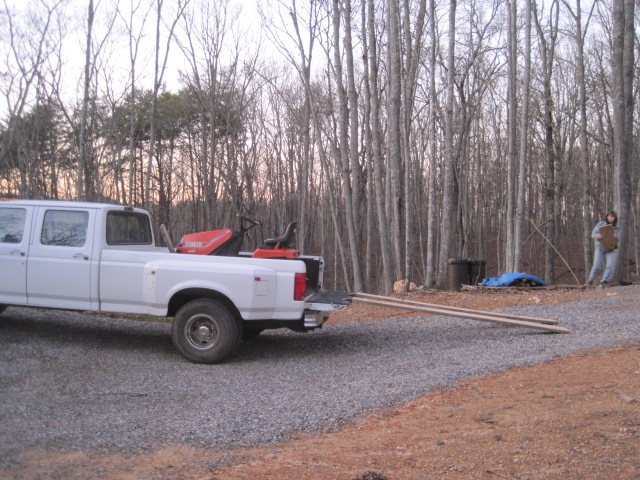

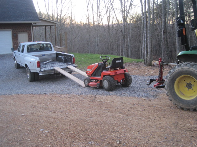

Hey guys, thanks for the ideas. However, my wife already made an appointment with the repair guy. I'm not expecting to pay more based on the fact that the lawnmower stopped working one week after bringing it home. The only time I fired it up was to unload it from the truck when we brought it home. The repair guy said he drained the gas tank put 100% gas (no ethanol) in the mower and recommended that I do the same.
We loaded the mower into the truck this evening. My wife got everything ready. My wife used the tractor to pull the mower out of the garage and up the hill to the end of the ramps. When I got home, the ramps were set up and all I had to do was help my wife push the mower up the ramps. The mower fits nicely in the truck bed so I don't have to strap it down.
