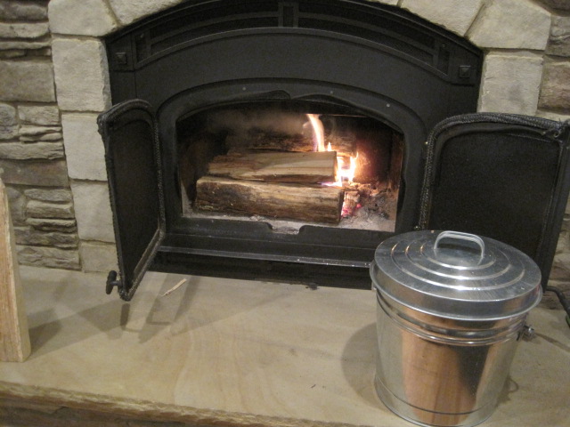

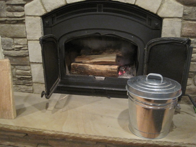

Tonight when I got home from work I cleaned the ashes out of the fireplace. We put the ashes in a heavy galvanized bucket that we purchased for the purpose.
Since we are heating the house with the fireplace, we have to clean out the ashes while we still have hot coals in the FP. We can't remove all the ashes but do get enough to keep the ashes from filling the fireplace and overflowing onto the hearth when the doors are opened.
I used the shovel to move as many of the coals as possible to the back of the fireplace. Then I shovelled the ashes remaining in the front of the fireplace into the bucket. When dumping the ashes into the bucket I have to be careful or the fine light ashes will puff up into the air and make a mess in the room. So I hold the bucket cover with one hand over the top of the bucket while dumping with the other hand the shovel full of ashes into the bucket. Covering the bucket as much as possible with the cover catches most of the ashes that would otherwise float into the room.
A few warm coals made it into the bucket so I put the bucket of ashes outside in the gravel driveway to let the ashes extinguish themselves.

Obed--Hi--
A couple of cold days down here in Charleston---fire was nice---The ash situation is just messy, although your system sounds fine with some hot ashes.....I usually wait til the fireplace is cold, and use a couple of plastic bags--one inside the other...Carefully shovel out a good sized scoop at a time and carefullly deposit in the bag, until about full..Then tie the handles together and ease out the house--carefully---I have a minimum amount of dust, but still a little.....I`v tried wetting the ash down with a small amount of spray, but is just still is a worse mess....Tony
   / At Home In The Woods #3,694
Try firing up a shop vac and hold the hose over the bucket and work slow. The shop vac should catch most of the fine ash dust that wants to float.

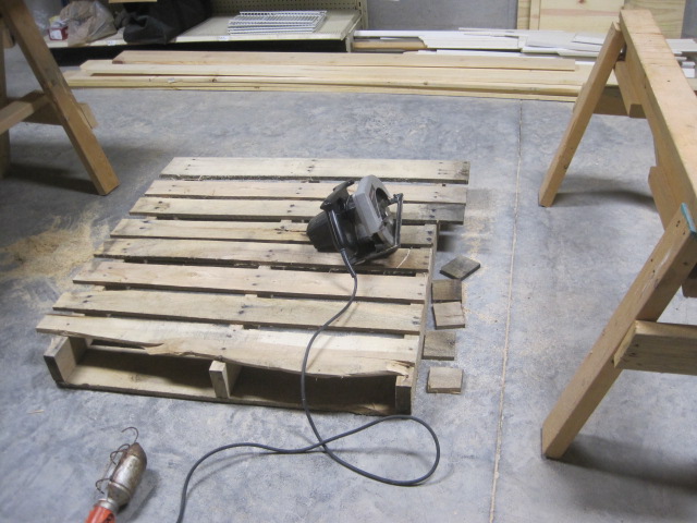

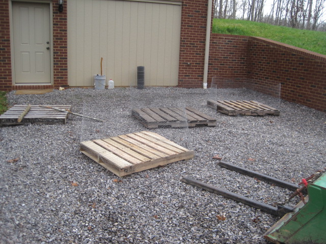

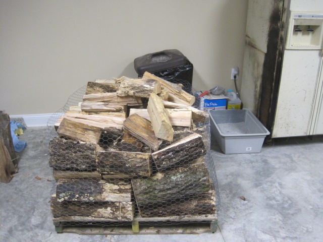

I've attached a picture of my aborted attempt at attaching vertical supports to a pallet a few weeks ago to keep the firewood on the pallet. The chicken wire pallet baskets are easier to make.
I've included a picture of the first pallet basket I made a couple weeks ago. The chicken wire does a great job of keeping the firewood on the pallet. I can throw irregular pieces of wood in it with no trouble. I have some one foot long logs in the basket. If you've ever tried to stack logs that are only a foot long, you know that they don't stack very well. The stack just wants to fall over. That's not an issue with the pallet basket.
Today my wife and I made 3 more pallet baskets using chicken wire. The slats on one of the pallets overhung the joists so I trimmed the slats with my circular saw so that I could attach the chicken wire to the sides of the joists. To make the baskets, I just staple the bottom of the chicket wire around the sides of the pallets. Then I splice the ends of the chicken wire together.
