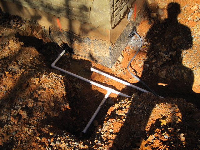

Garden Water Line Question
Hey guys. I have asked the grading contractor to give me an estimate for running a water line from the house to the garden area. I told him I wanted two 1" PVC lines buried 2' deep. The second line running to the garden is a spare in case the first line breaks. I'm guessing we are talking around 200' of trench. I would like to run the water line to the garden before we put down topsoil and seed our yard.
Question #1: While the trench is open, can you think of anything else I should put in the trench?
attachment.php
In addition, I would like to be able to shut off the garden water line close to the house. The picture above shows where the water line that runs from the well meets the house. The second pipe is a spare. There is a T-connection with a 2 foot long pipe capped off. The capped off pipe was put there in preparation for running a water line to the garden area. These pipes have long been covered up about 2 feet below ground.
Question #2: I would like to put a valve in the waterline below ground to prevent freezing. Do you have any idea how to do this? Obviously I need to access the valve in order to operate it.
Thanks in advance,
Obed

   / At Home In The Woods #3,126
Why not just run some PEX straight from the house and put a 2' burry yard hydrant at the garden. Pex will not crack even when frozen and the yard hydrant will not freeze since the water drains out the bottom when shut off. You could always put a shut off valve in the house.
   / At Home In The Woods #3,127
While the trench is open: Speaker wire? Who knows you may want to listen to music while gardening and the trench is open. But seriously, do you want an outlet out there to run electrical tools for gardening, etc? Just a thought, and smart to do it while it is open the first time.
   / At Home In The Woods #3,128
Orange snow fence may be your best option to keep them away from trees, but by the time you get it in they will probably be done.
You can always add an electrical conduit or 2 in the trench so you can pull wires later on (LV or power or both but you don't want to run both in the same tube).
There are faucets that have an extension to shut off below the frost line, but I think those all include a hose bib (outlet), and are not a simple line shut off. If you wanted to get crazy you could use a shut off like they do at the street for city water. I think your best bet is to put it inside the basement.
   / At Home In The Woods #3,129
I know I'm crazy, but the fact that I have curb valves and water valve boxes on all my water lines must prove it.:laughing: It does make it easy when you need or want to work on a line though. Remove the lid from the box, drop the valve handle over the valve, give a quarter turn on the handle, and replace the lid. Done.
Thanks in advance,
Obed
I would recommend running automatic sprinkler cable out to the garden area. It's inexpensive and if you ever want to automate the watering this will make it much easier.
