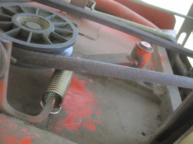

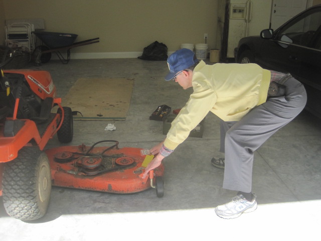

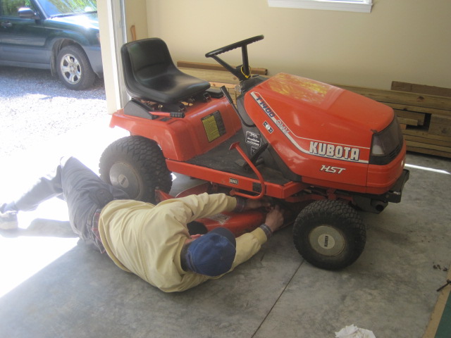

Replacing the Drive Belt on the Kubota Mower
In order to fix the issue I had getting my mower to drive up a hill two years ago, I replaced the drive belt, tension pulley spring, and fixed the tension pulley. Unfortunately, the mower is having trouble moving again. So I decided to try replacing the drive belt again.
View attachment 423375 View attachment 423374
I removed the mower deck.
The pulley in the left side of the picture is attached to the gearbox that turns the rear axle. The pulley in the right side of the picture is the tension pulley. You can see the arm to which the pulley is attached that provides tension on the belt using the spring attached to the tension arm.
I removed the rear pulley in order to remove the 2 year old drive belt.
I replaced the 2 year old Kubota belt with a new Kubota belt. After installing the new drive belt, the mower still had problems moving, especially up a slight hill. Upon closer inspection, it appears that the tension spring I replaced 2 years ago didn't appear to be stretching hardly at all. The spring looks to be too long to do its job. The belt feels much too loose.
So my wife found the old spring I replaced 2 years ago.
The shiny one on the left is what I put on the mower 2 years ago. The rusty one on the right is the original spring. The replacement spring is definitely longer than the original. It appears that the Kubota dealer sold us a spring that is too long to put proper tension on the drive belt. My wife is going to go back to the dealer to see if we can get a spring that matches the original. Our mower was manufactured in 1989. I wonder if Kubota no longer makes the original spring. Finding a replacement may become a headache.
   / At Home In The Woods #5,887
Other than a little surface rust, there is nothing wrong with the old one. Put it back on if you can't get the right replacement. You really, probably, only needed a belt in the first place 2 years ago and went overboard.

I did reinstall the original spring; the mower worked a little better than when using the newer spring but not well enough. I think the original spring has weakened over the years.

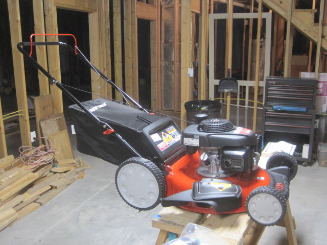

My New Push Mower
It is a Troybilt TB130 with a 160cc Honda engine. It is not self-propelled. I can push a non-self propelled faster than I can walk behind a more expensive, heavier, and harder to maneuver self-propelled model. So I greatly prefer a push mower over a self-propelled mower, even if both types cost the same.
Assembling the mower was fairly easy.
The MTD YardMachines mower that I returned to the store last week had this exact same "Slope Gauge" picture in it. The consumer grade mowers all seem so similar it is tough to believe that they are actually made by different manufacturers. It makes me suspect that a company in china makes them all and each "manufacturer" specs out the engine model, color, and a few minor cosmetic differences to the "actual" Chinese manufacturer that "actually" builds the machines.

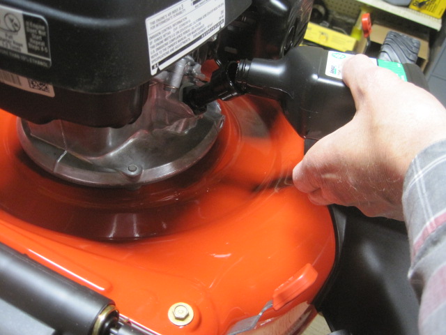

This Troybilt mower with the Honda engine actually has an accessible oil cap and dipstick.
I doubt I will ever use the grass catcher function. I don't understand removing grass clippings from the yard. The clippings provide very useful organic material that keeps the topsoil healthy. In addition, bagging the grass is time-consuming and not any fun.

My wife went to Kubota today and asked them about the mower drive belt tensioner spring we bought from them two years ago. They said they had sold us the wrong spring. They ordered a new spring which should arrive at the end of this week.
