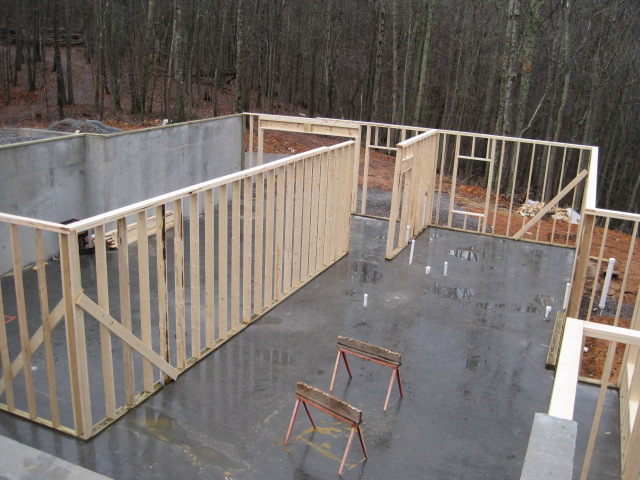

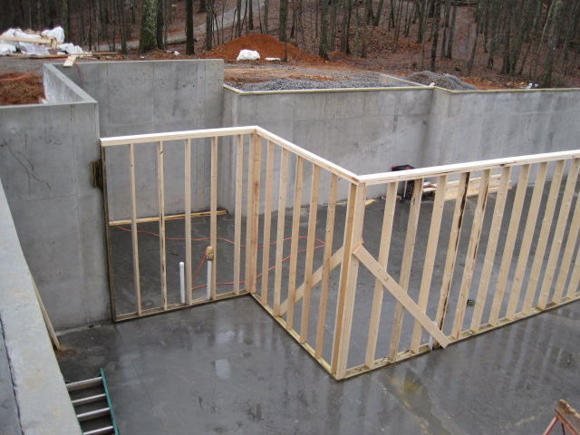

The interior load bearing walls went up Friday. The long portion of the wall will actually have 2 doorways in it. The framer didn't put in the doorways yet because he wanted my wife to confirm the location of them. He said they would be easy to add later.

   / At Home In The Woods #288
That's good that the framer used treated lumber where it is contact with concrete. Wood will always absorb moisture from concrete when they are in contact. Did he put in sill sealer too?
Dave.
#289
Dave.
I'm not sure if sill sealer was used. The hardware (nails, screws, hangers, etc.) that touches the pressure treated wood is hot-dipped galvanized per the code. Apparently unless you make them, builders around here frequently skip using special hardware made for pressure treated wood even though the code requires it.
Obed
   / At Home In The Woods #290
Obed,
What are you finishing the floors with? Some of those puddles look pretty big. While the water is sitting there, put a tape measure in them and see how deep they are. If it's just an eigth of an inch, then that's fine. If it's more, then depending on what you are doing for a floor, you'll need to make them level.
Tile and carpet don't care, but wood really likes a flat surface. Vinyl is hit or miss, depending on the hole and brand of vinyl. Some are stiffer then others, while others will form to just about anything.
Getting your concrete guy to fix it is cheap right now, because it's his mess up. Having the flooring guy do it down the road is expensive, because it's more work on his part that he'll have to charge you for.
