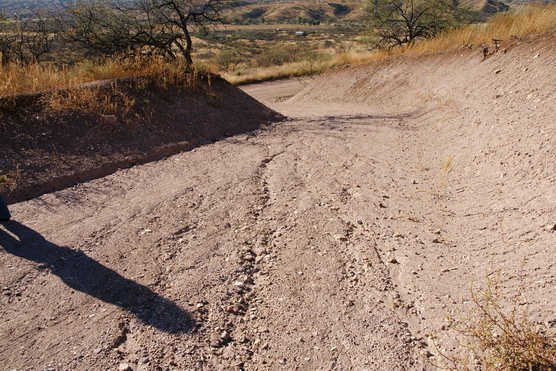

Wow, you're really moving along. I find your story fascinating because we are on the brink of starting our house, not in the woods, but in the high desert outside Patagonia Arizona. I'm planning to take our camper and stay on-site and supervise construction. I've learned a lot from your posts and I thank you much. Keep it up you're doing us neophytes a real service.
I added a few photos, the second is the south view from our place in AZ. Somehow we fell into this land which has 320 degree mountain views. It slopes gently to the south, perfect for a passive solar house. The only downside is the world's steepest driveway. The other pictures are of the only thing I've ever built, our 14 X 20 cabin in SW Wisconsin. The best part about it is the tractor parade that goes by each August. Those guys drive those classic tractors miles and miles in the hot sun.
Congratulations on your upcoming baby and new house!
