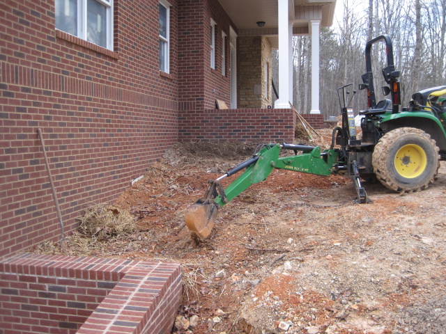

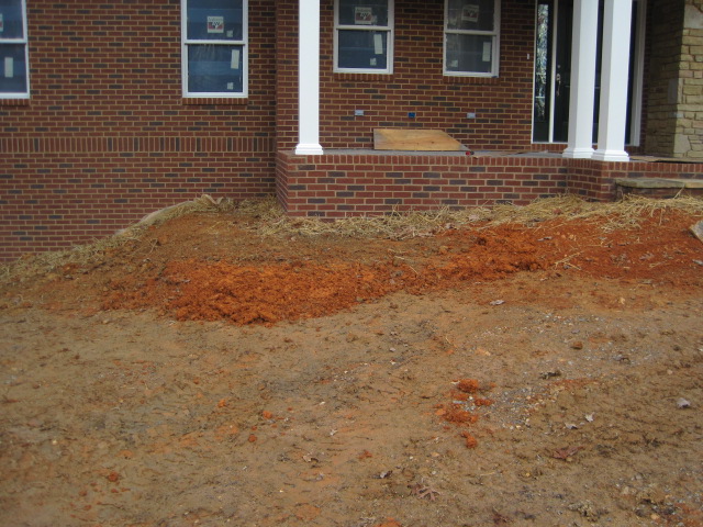

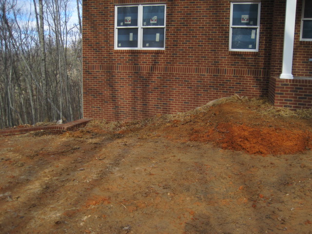

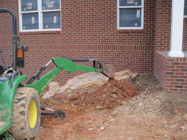

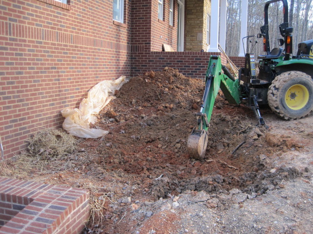

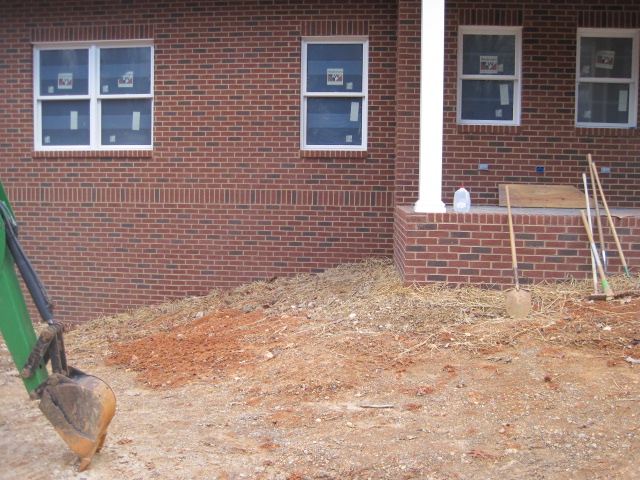

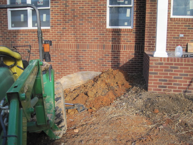

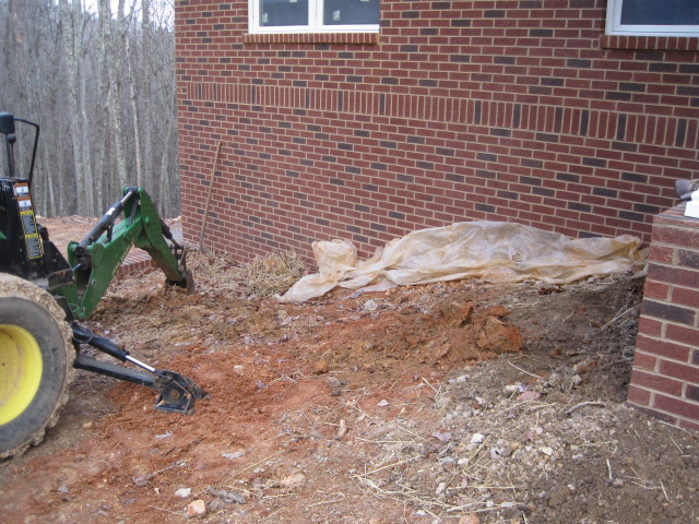

Today I added dirt around the front porch to better meet the 30" maximum porch height requirement. I used the backhoe to remove dirt from a spot that is too high and deposited the dirt beside the porch. Certainly I hope the extra dirt will satisfy the inspector. I will eventually fine tune the grading in this area to be able to mow the area with a riding mower. But for now I hope it's good enough to get us into the house.

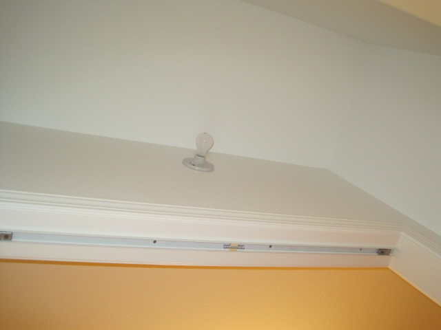

Electrical Inspection
We had our electrical inspection today. The inspector found some things that need changing. We have 30 days to make the changes and get another inspection.
The outside HVAC unit had romex wire running through a conduit to supply power to the unit. Romex is not allowed inside the conduit. It must be replaced with UF wire.
We have keyless incandescent light fixtures in two bedroom closets; they are not allowed. The fixtures must have globes that completely cover the light bulb.

Our electrician said he would send his workers out Tuesday to make the changes. We will need to buy two light fixtures for the closets beforehand.
