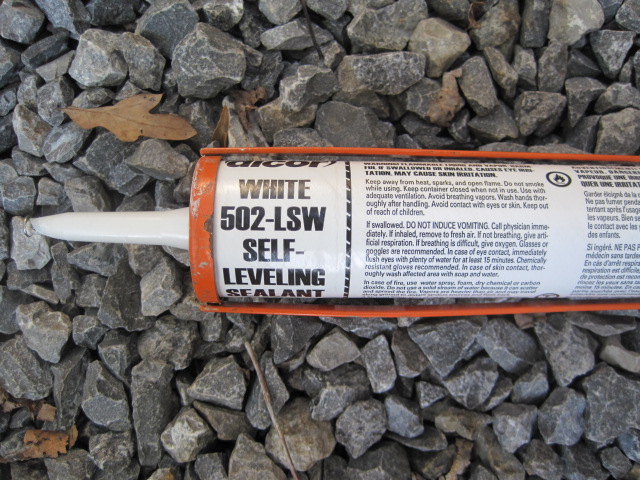

Yesterday after we stopped working on filling the front porch, I caulked the camper roof with the self-leveling caulk. The whitest parts in the picture of the roof are the spots I caulked. Over the 13 years I've lived in this camper, I've tried various things for repairing roof leaks. The self-leveling caulk has worked the best for me. Self-leveling caulk is a little "runnier" than regular caulk. After laying a bead, the bead will flatten out and will be flexible after curring.

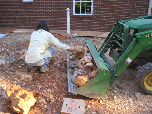

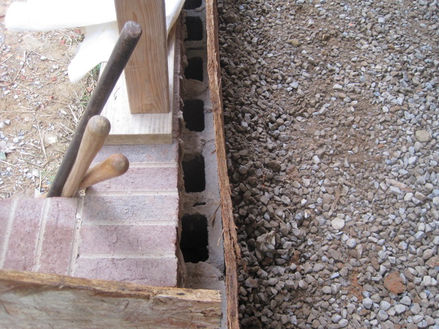

We worked more on filling the front porch today. We finished picking up the remaining piles of brick debris. My wife added some rocks lying around the back of the house.
We used some scrap OSB to keep gravel from falling down the inside of the blocks. When we pour the concrete porch slab, we will fill the blocks with concrete. We have rebar in the blocks that will provide support once the blocks are filled with concrete.
