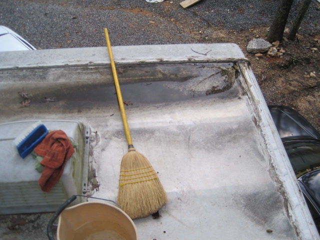

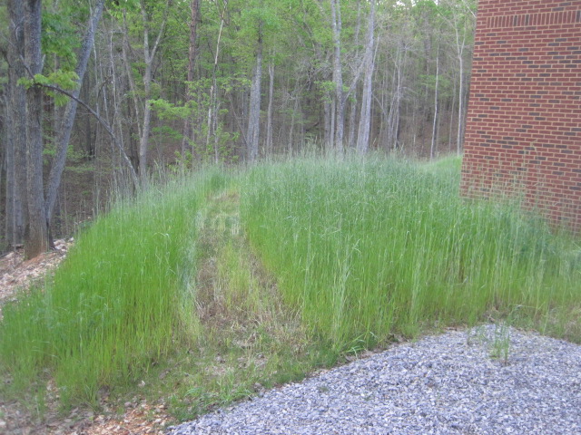

We had a day and a half of steady rain. The camper developed a leak and got my wife's closet and clothes wet. Tonight I cleaned the area on the roof. I'll give the roof a couple of days to dry out and put some self-leveling caulk up there. It was pretty obvious why it was leaking. I'll be happy when I no longer have to live under a flat roof. You can't really fix a flat roof; you can only patch it. Relying solely on caulk to keep water out will only work for so long; water will always win unless you can redirect it.
I don't know what self leveling caulk is, so maybe that's better, but in my experience, silicone and caulking are terrible at stoping leaks on RV's and any other roofs. You need roofing sealing, or flashing sealant. My favorite is Henry, which is sold at Home Depot. It's miserable stuff once you get it on yourself, but it works. It's extremly sticky, water tight and flexible. It's twice as much money as silicone, but once you use it, you are done.
Good luck,
Eddie
Good luck,
Eddie
There are "lap sealants" made for RV roofs. I think that is what he meant.
