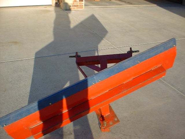

Well, after seeing some damage done to a concrete drive by another good samariton (not me) I decided soem mods needed to be done on my rear blade for snow pushing. I decided a plastic edge guard was in order. Some driving about my favorite stores to hang out in I came upon the perfect chunk of plastic. Check it out now attached to my blade. I sure hope it snows again /forums/images/graemlins/grin.gif. J

Check out this edge view of my new plastic edge guard. Now all I need is some skid shoes. J

Ok , I'm hooked, what did you use for edging? It looks great.
I'm probably going to get a rear blade and agree that it needs some edge protection.
I'm thinking of also welding on some brackets on the back of the blade moldboard and installing some caster wheels that can be adjusted up/down an inch or so. Then I'd plan to adust the blade (on dry/level pavement) to be about 1/2 inch off the surface. Casters would work at any angle you set. They'd be fairly easy to remove for doing dirt work.
Comments to this idea?????????

Ron, I found the material at the Yard Store. They charged me one dollar per pound so it was about six dollars. Unfortuantely, I got the only two four foot pieces exactly of this shape. Since my blade is a 60 inch I cut them to splice together. There was other of the same mateial that would need sawing and routing to accomplish the same thing. I don't know how well it will work and it does not look good for more snow soon.
They also had some 4X8 sheets of white nylon about 3/8 inch thick. Until I spied out my blue plastic chunks it was my plan to purchase the nylon and then saw it into two 60X4X3/8 pieces and one 60X2X3/8 and then essentially laminate them together. I would have probably used the three pieces bolted together to achieve the same result as I have now. Like the new Titan commercial says, "Bring It On", the snow that is. J
