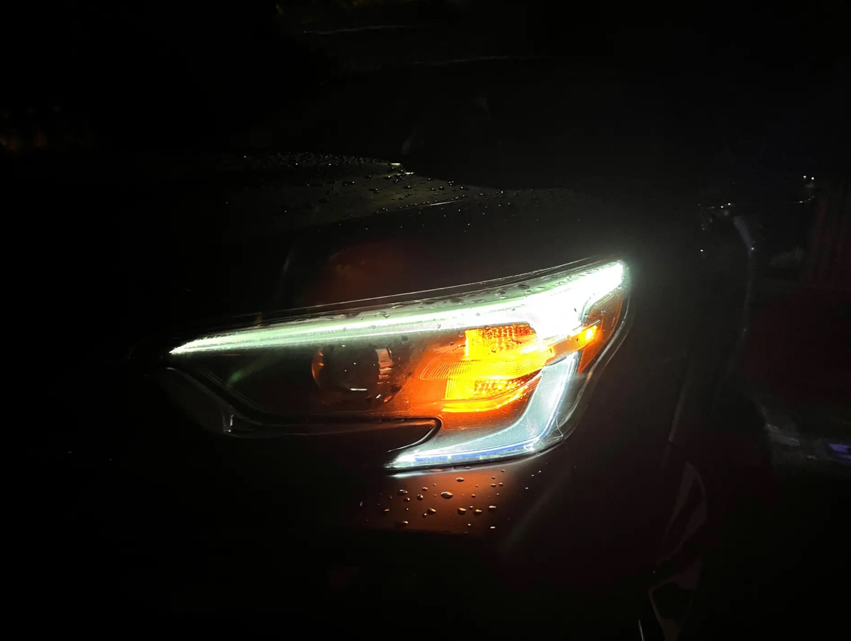

Our 2020 Subaru Outback is probably the WORST car I've ever driven at night in a snowstorm due to its lighting! Drive-wise, it's a beast in snow. ZERO issues. Lighting-wise, it's horrible!!!
The daytime running lights are around the headlights.
They shine in all directions, even UP! So if you're driving into snow, with your low beams on, these DTRLs shine UP and illuminate all of the falling snow right about eye height. Even if you turn off the headlights, the DTRLs are still on, and make it hard to see in falling snow.
Another thing is as you travel along in falling snow, the headlights get dimmer, as the snow and ice stick to the headlights and don't melt off as with old high wattage bulbs. The LED headlights generate little heat.
So about every 30 minutes you have to stop and clear the headlights.
BAAAAHHH!!!!!
Rant over. :p
I'm going to see if there's a fuse for just the DTRLs. If there is, I'm going to make them switchable. If not, I'm considering duct tape over them. 🤣

Yep, they are the C-shaped light rings around the outside of the headlights. In earlier models, they were the high beams on lower setting.
I think I found a way to disable them. It appears there is a 5 pin relay for the right and left ones. People have mentioned you can replace the 5 pin relay with a 4 pin relay and that'll kill the C lights.
I'll try that first, then if it works, figure out a way to wire them to a switch as the only time I want them off is when the snow is falling.

Can I suggest considering the use of a relay with a momentary pushbutton control, so that the DRL will automatically revert to "normal" function when you turn the vehicle off?
