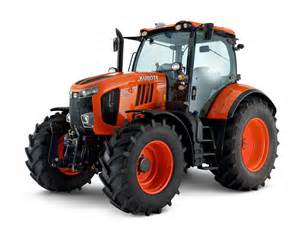

Go back to the photo in the first post and it does look like newer models of larger tractors do seem to be coming out with larger diameter front tires and are engineered for them.
Here's a Kubota to go with the photo of the Case in the first post.

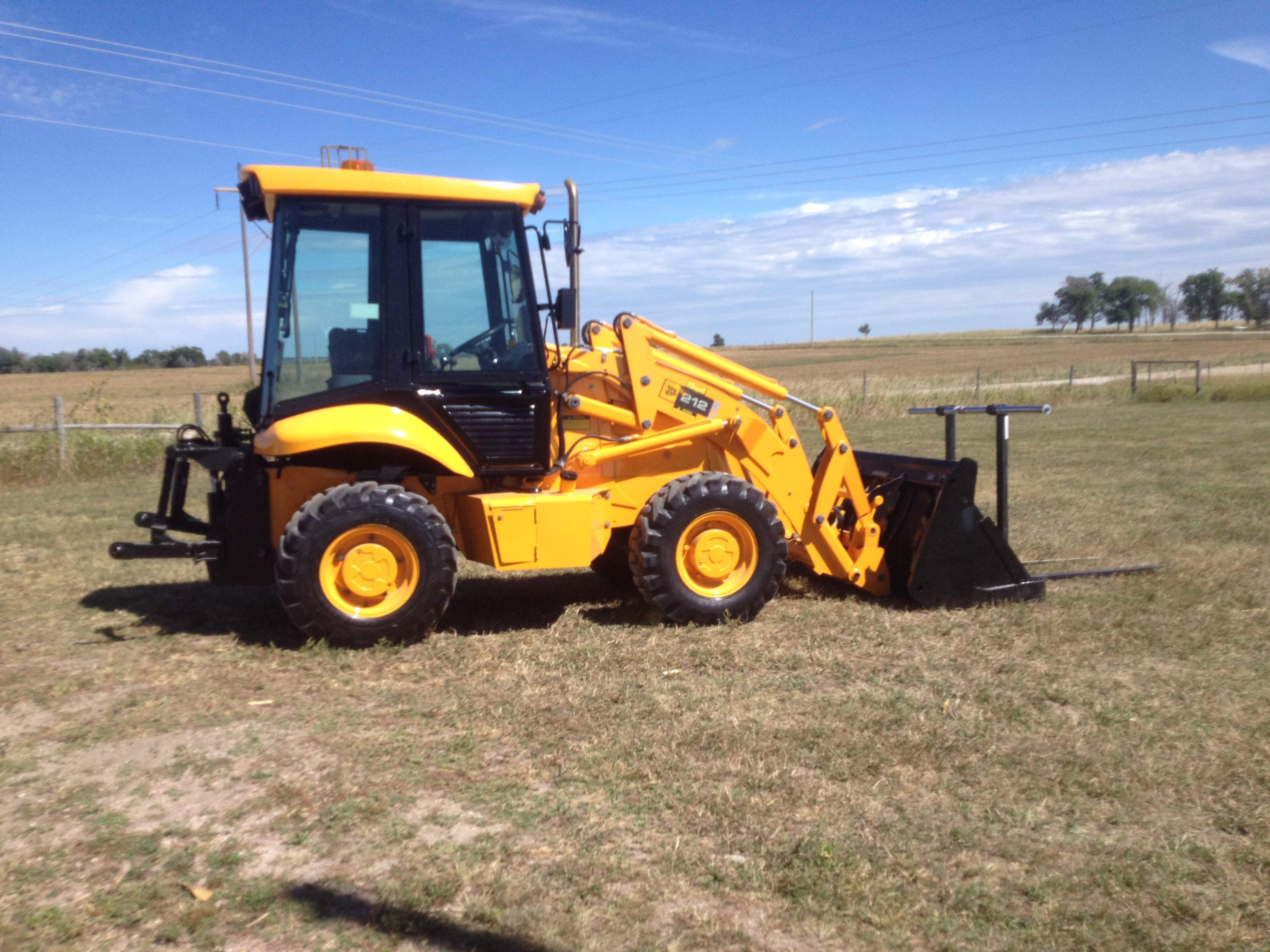

Is that possible?!?!
*grin * it would take lot more than just that to make my redhead happy... but it sure would be a step in the right direction. She hates it when I drive anything in her 'her' yard!
