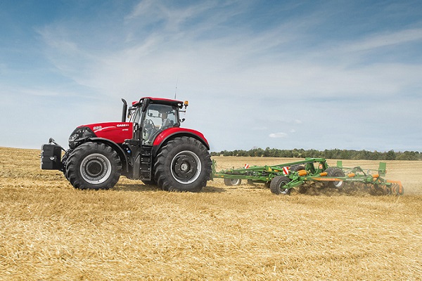

Are tractors evolving to more equally sized front-to-rear tire sizes?
Nothing scientific here but the new Kubtoas look like they have bigger front tires and now I see the new Case with bigger front tires.
Is something going on that I don't know about?
