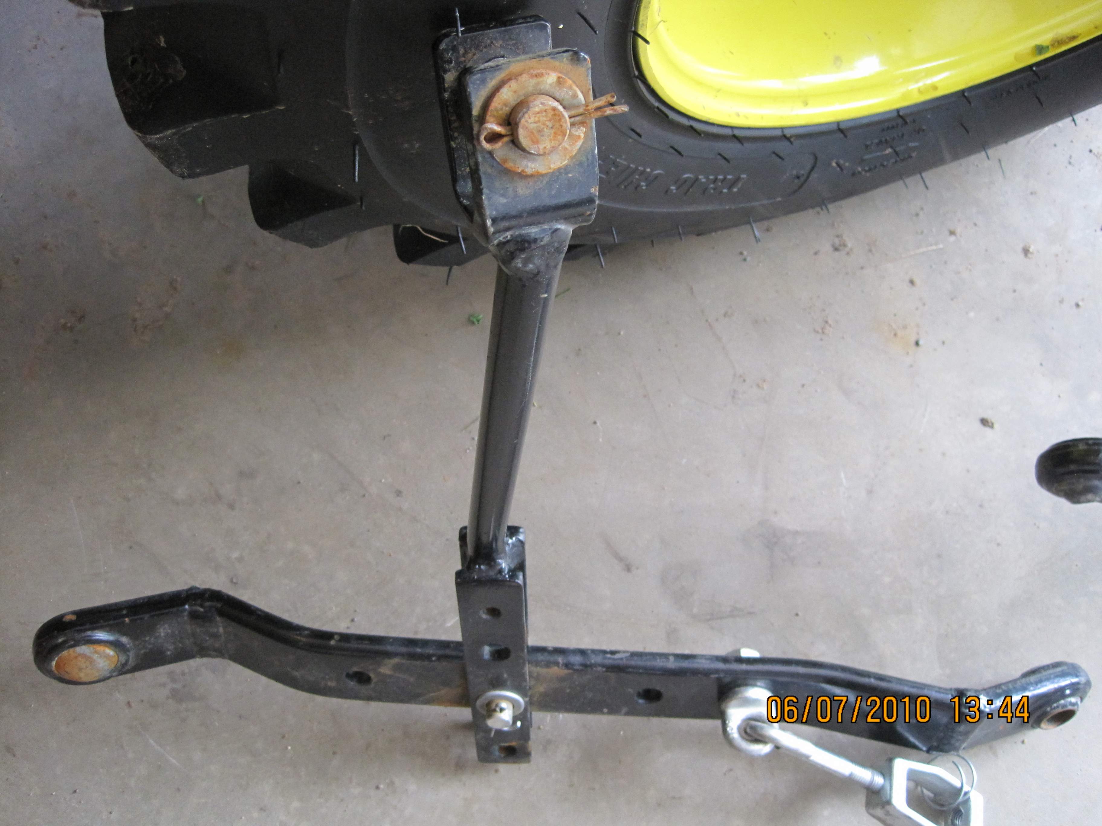

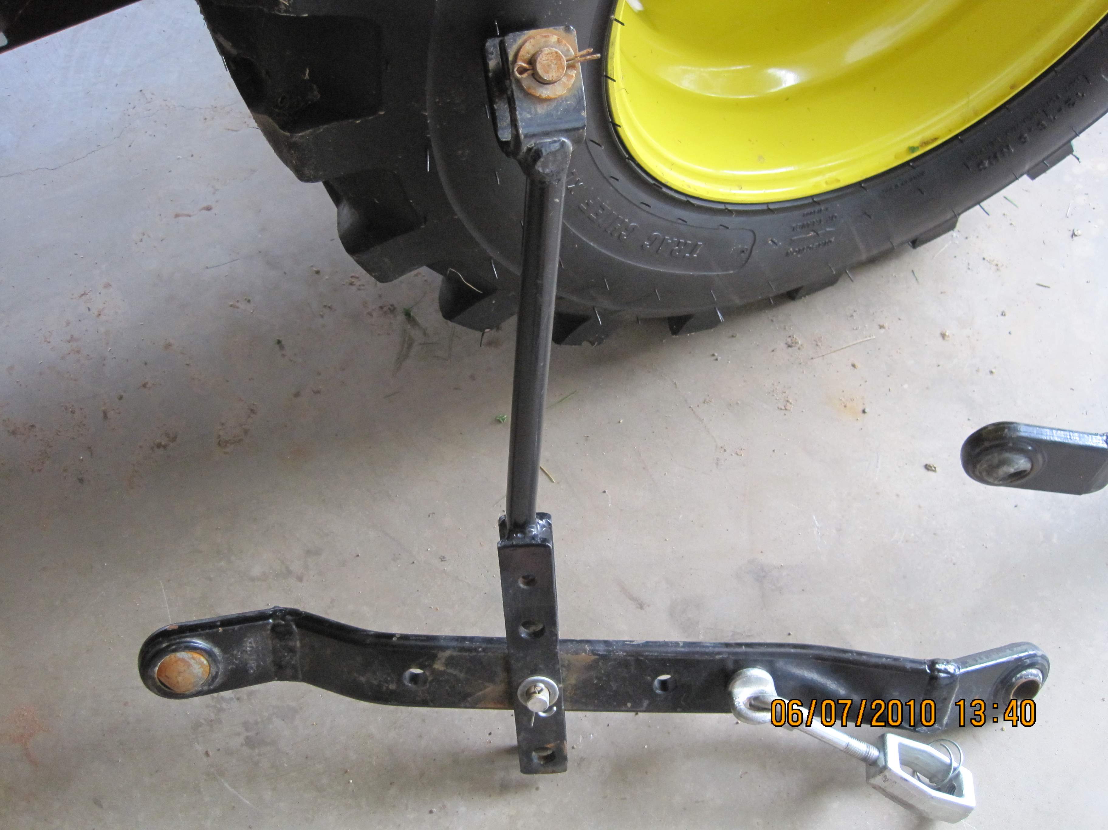

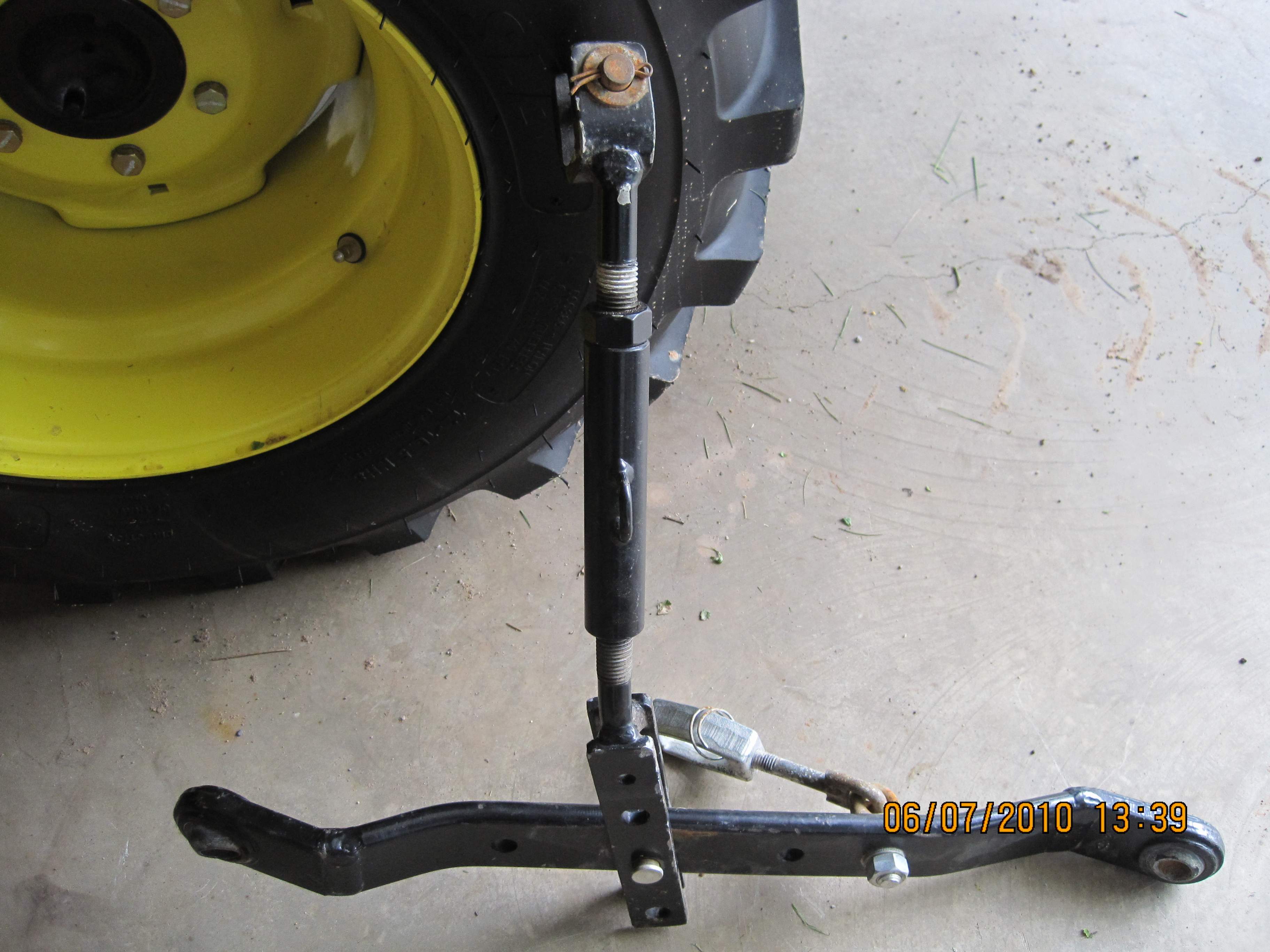

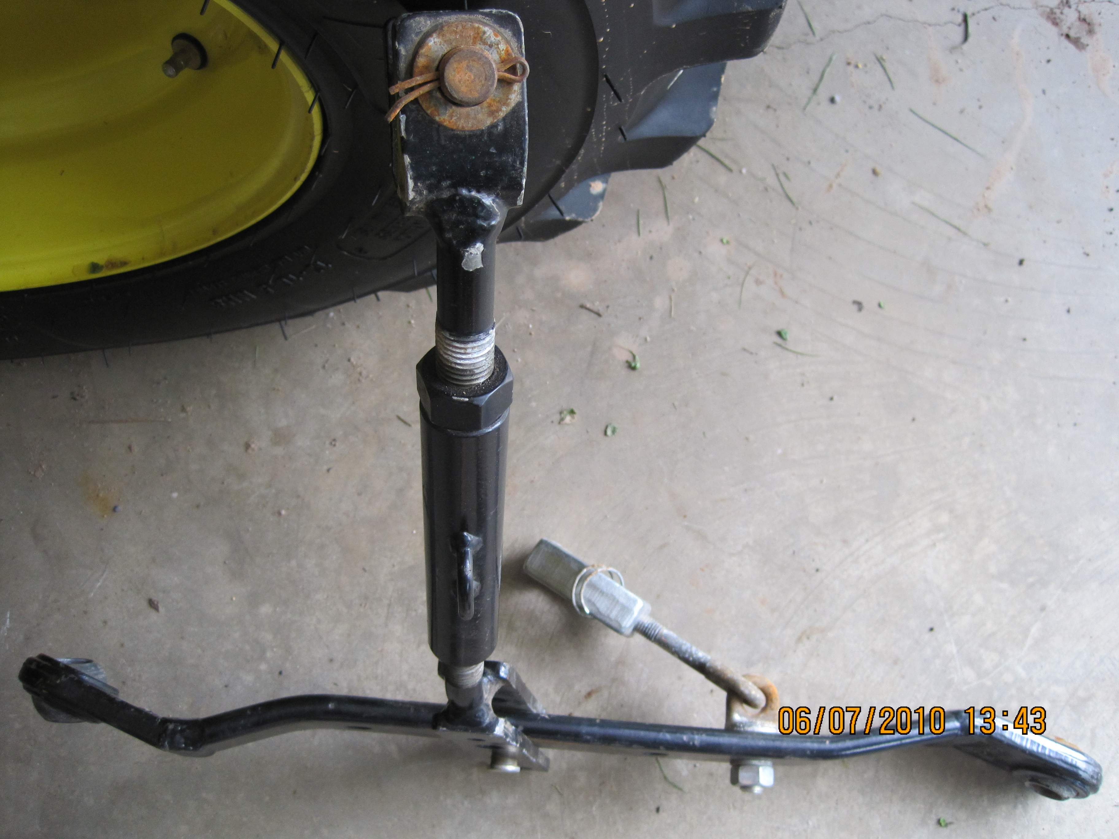

Hi everbody. Just bought a new 2320 with FEL and BH. I have some questions about the 3pt hitch. The tractor arrived with the BH attached and the lift arms etc in a cardboard box marked as for a 2720. Dealer doesn't have another 2320 on the lot at the moment so I can't do a direct comparsion. Hopefully the attached pics will help. Also is it obvious if there is fluid in the transmisson sight glass? I can't tell if it is completely full or empty. I can't see a bubble. I wonder if it may be low as the tractor seems to be noisier then the 2720 I tried out first. Is there a way to tell model year based on serial #? thanks for any and all help.

The sight glass has a white background, with (usually) amber colored fluid being visible against the white--if you are seeing all white you may want to do a fluid check and fill. On the arms--I can't tell you if they are the correct part number--they look Ok--but I'm sure they look used!
   / Are these the correct lift arms? #3
Those certainly look like used lift arms off a 2720 to me not a 2320 or 2520.
The 2720 has the bend and welds on them.

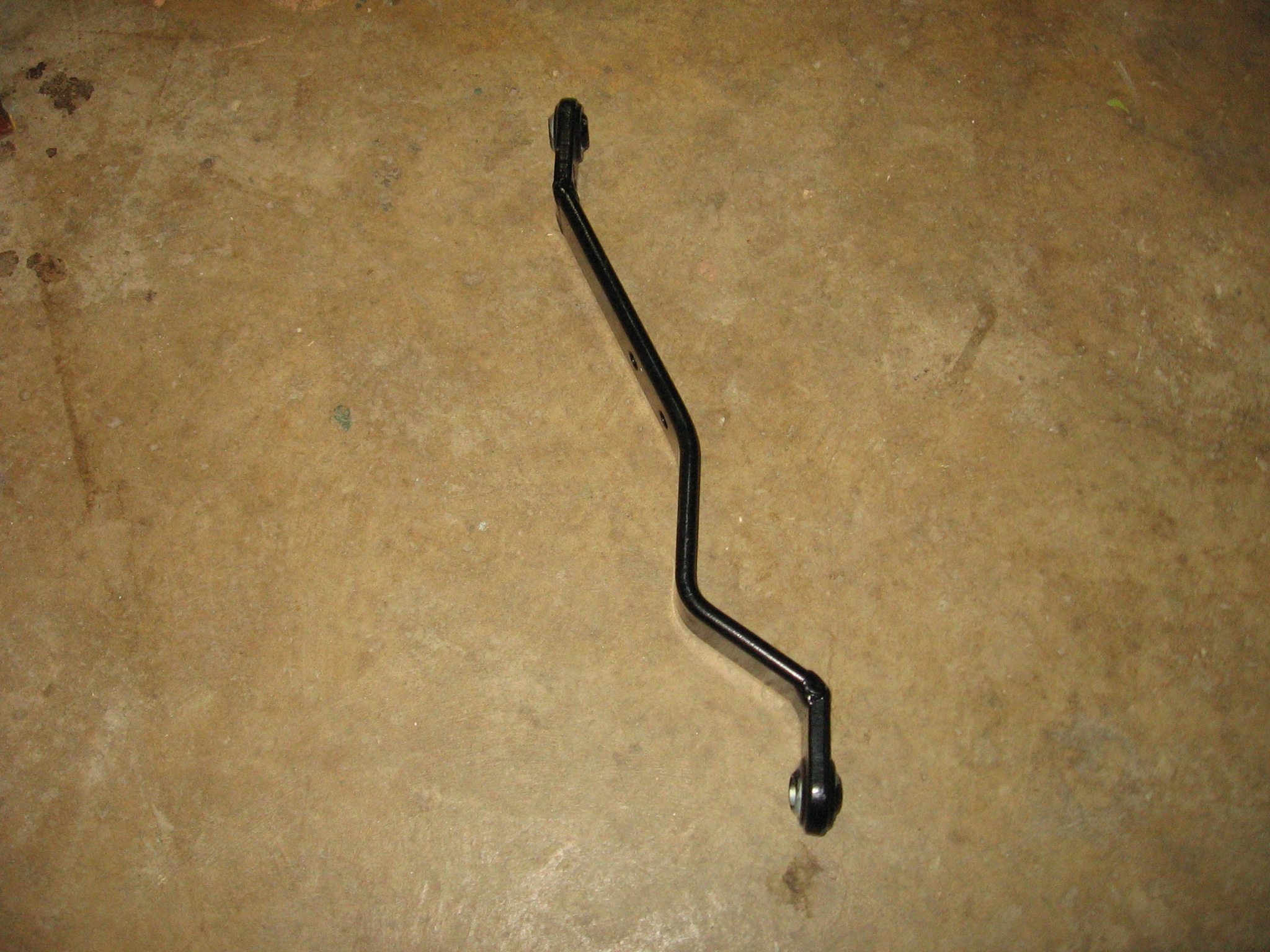

First pic is the new style arm for the 2520 and 2720,the second pic is the older style arms for these two tractors.
I don't know what the OP arms are off of. They sure aren't from a 25 or 27.
Could they actually be 2320 arms?
