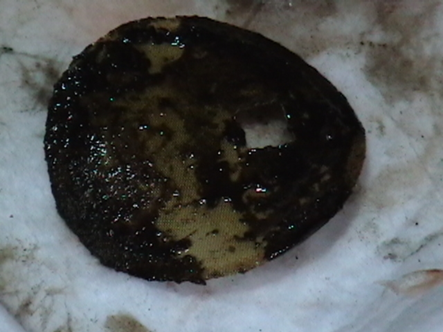

Sediment bowl.
Sediment bowl screen with dead diesel bugs.

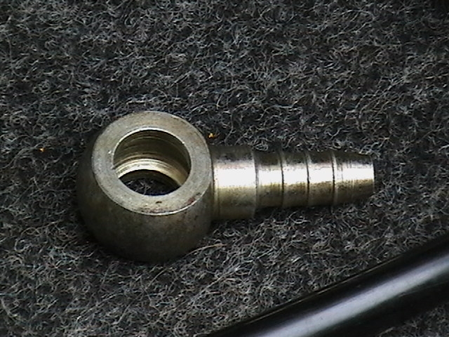

Banjo bolt screen.

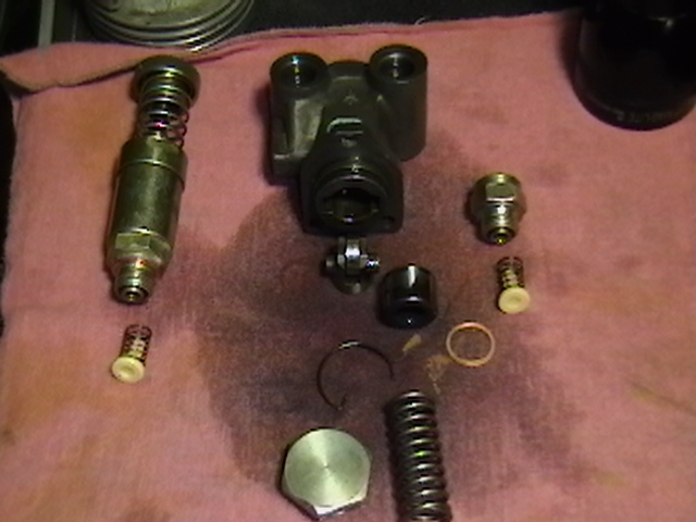

Lift pump assembly. The priming pump can go on either side. The two white things with spring are the check valves that make the pump work. The round black cylinder in the center is the lift pump plunger.
