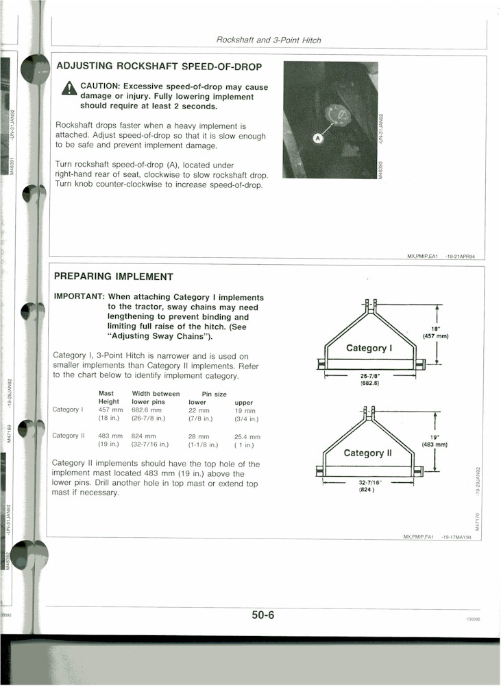

I have no also entered the nightmare of installing a 3PH.
I can't even figure out if this is a Cat 1 or Cat 2 hitch!
I thought adding a 3PH was a simple thing... JD wants about $2000 for all the parts I think. But I find 3PH kits online for a few hundred bucks. Why such a big difference? Are the online kits not any good? There's no way I can pay 2K to add this.
Completely confused and bummed out. Help please... :-(
   / Are there any JD 5400 Loader/Backhoe owners out there? #14

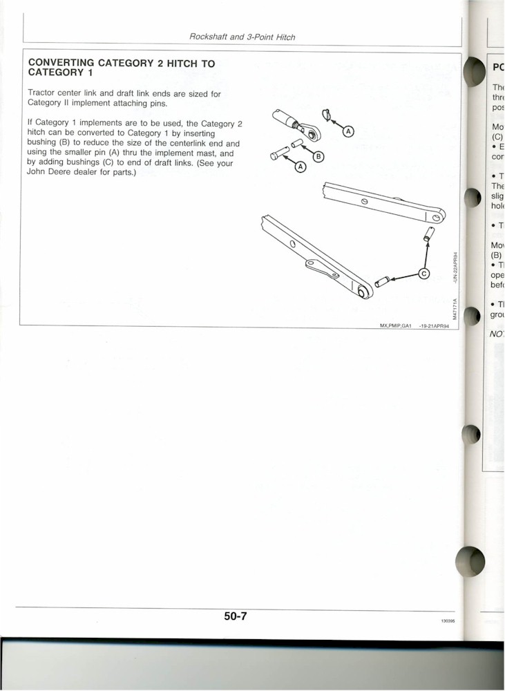

The 5400 came with a Category 2 hitch, but could be converted to Category 1 as shown in attachments.

   / Are there any JD 5400 Loader/Backhoe owners out there? #15
OEM should be CAT II. Unless you (orginal owner) purchased the optional CAT I hardware from Deere.

For parts try T and H Salvage in Pavo, GA for parts. If you hook the wrong hoses on the tractor together you won’t be able to crank it. The starter will not be able to overcome the hydraulic pressure. I have a 5300 with a 10A backhoe.
The three point hitch comes as Cat 2. You can buy Cat 1 balls for the lower arms from John Deere.
