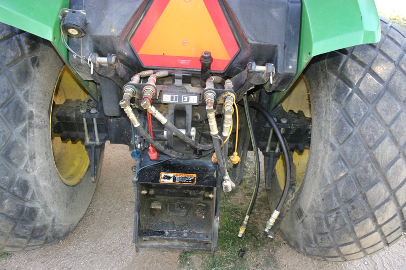

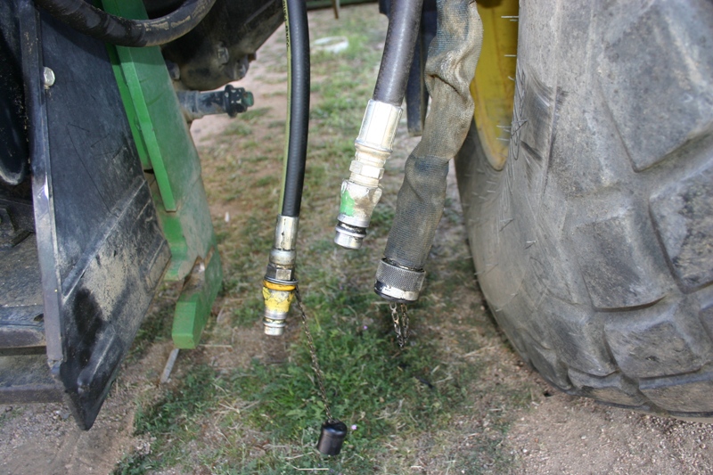

You need to connect the yellow male tip to the female for proper flow to the rockshaft. If your present turf tires are 16.9X30, you can get ag tires to fit the same rims. Firestone can supply them as well as others. Firestone Agricultural Tire Division . You might check with local dealers for left over tires from swapping around tires. Sometimes you can find a bargain.

I have no also entered the nightmare of installing a 3PH.
I can't even figure out if this is a Cat 1 or Cat 2 hitch!
I thought adding a 3PH was a simple thing... JD wants about $2000 for all the parts I think. But I find 3PH kits online for a few hundred bucks. Why such a big difference? Are the online kits not any good? There's no way I can pay 2K to add this.
Completely confused and bummed out. Help please... :-(

For parts try T and H Salvage in Pavo, GA for parts. If you hook the wrong hoses on the tractor together you won’t be able to crank it. The starter will not be able to overcome the hydraulic pressure. I have a 5300 with a 10A backhoe.
