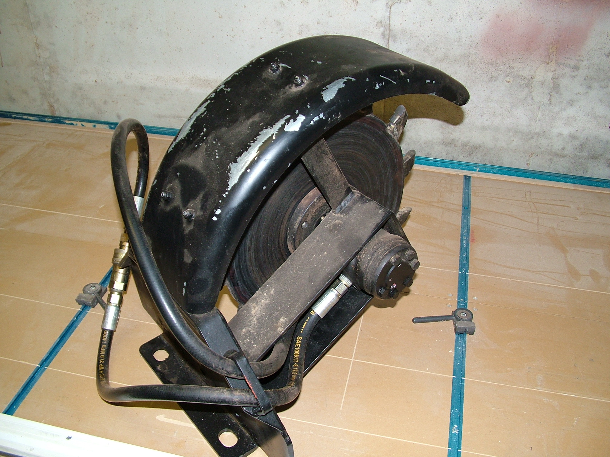

This was a very simple and effective way to help eliminate stump chips from flying back into my face.:thumbsup: Drill and bolt a Galvinized boat trailer fender to the grinder

I'm reviving this old thread to ask a safety question. Many people have suggested, over the years, to reverseing the direction of the stump grinder since it throws chips back on the tractor and operator. I was intending to make this modification myself. However, Wa****a notes in this thread that his wheel came off and "imbedded itself in a tree." If I reverse the direction of the wheel and it comes off, isn't it likely to climb the tractor and embed itself in my skull?

If you reverse it it will throw chips out to whoever is standing in front. What is to keep someone from crossing in front of you while you are watching the stump grinding? I see what you mean about the wheel heading towards you. I would be reluctant to change this.

how quick are your reflexes? RPM X circumference of stump grinding wheel = Feet Per Minute, how many feet will that wheel travel in the split second it takes the operator to realize the wheel is coming for him?

Try grinding the stump starting on the side of stump grinding a hole next to the stump then proceed to grind through the stump from one side the the other. You will use the front edge of the cutting wheel to grind with and not so much the bottom. This will shoot the debris at the ground before it shoots at you. This seems to work better for me with my Vermeer 252 grinder than if I just drop the wheel on the top of the stump and grind. My grinder has rubber flaps that are used for chip containment. Perhaps a large truck mud flap could be attached to shield the tractor. But I think if it shields you you won't be able to see what you are doing.

I have always worked from the front of the stump. not the top but mine also blasts the chips away from me. I do not let anyone around when I am grinding.
