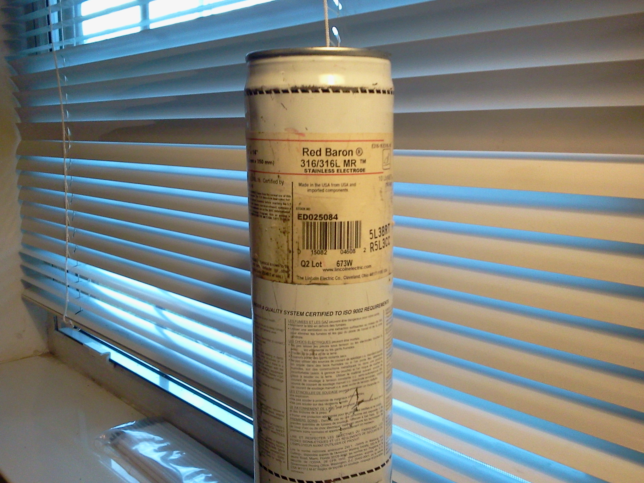

I've just picked up an unopened 10 lb can of Lincoln red baron 316L MR...for........let's just say cheaper than I should have:shocked:( Pays to keep your eyes open.) Still not sure what to do with it.
Need some stainless worth joining now. But the point is, every can of Red Baron I have used (mostly 309L) the slag has chipped or slid right off. I've never tried blue Demon. The only time I had a problem was when I forgot to reset the polarity...and it acted similar to what you describe.

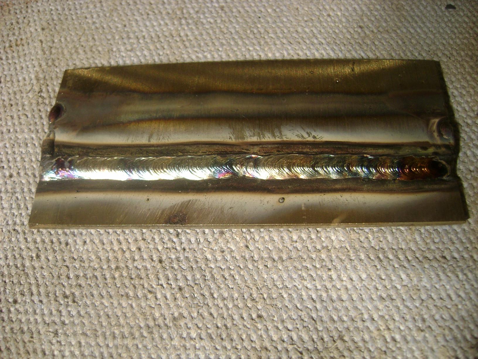

When I first got my PA-200 I tried some 316L-16 that I've had for around 38-years. Before I could get my hood up the slag was jumping off the weld.:cool:

Can't tell as the brush marks are camouflaging the metal, but is that stainless or were you simply playing around on some less expensive steel?
/ Arc Welding Stainless Steel #6
Grind marks?:confused3: I have no idea what type of stainless steel that is, came off a luggage carousel conveyor.
/ Arc Welding Stainless Steel #7
Sorry, I was looking at it on a smaller screen size. It's brush marks. But it is stainless...
