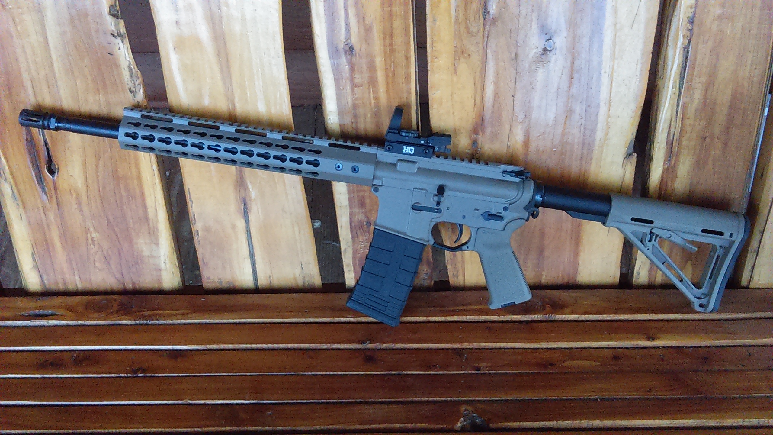

I ordered a complete kit with 80% lower from Daytona Tactical. They had some negative reviews for not responding to emails and people who didn't seem to understand their stated lead time. I took a chance on them because they had what I wanted in-stock at a good price. (Flat Dark Earth 16" kit)
They shipped mine within two weeks and everything was as stated. The only updates I got were an order acknowledgement/being processed when I placed the order and a shipping notice/tracking info 9 business days later.
I finished my lower on my mill-drill equipped with $70 2-axis basic DRO after practicing on a scrap block of aluminum. I even installed the trigger group in the practice block. I borrowed a jig just to clamp it for milling. Only a few rounds through it so far but it has functioned perfectly. The trigger feels good with about a 6lb pull.
