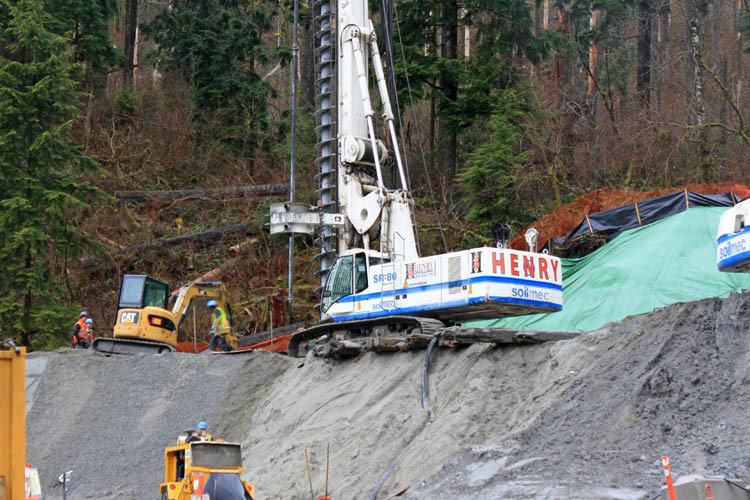

Did anybody read the OP's questions?
He doesn't want anything fancy for the few holes he does a year. Why are we telling him to go top of the line $2000 units? Heck, he ought to get a self propelled diesel track unit.
But, if he doesn't buy adequate, serious equipment as pictured, he is just playing with toys.
Bruce
