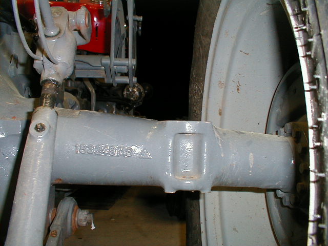

I'm trying to get some ideas on building a ROPS for my tractor and I wanted to see some pictures of how others are made. My problem is that the axle slopes up from the flat spot where the fender bracket mounts. I wanted to see how others deal with this -- shim up the plat to compensate for the incline or heat and bend the plate (1/2") to fit? I've attached a picture that shows the angle.

I have the exactg same axle on my 202
Part Number RMF103 hurcules.com good pics, they raise the plate up about 1/2 from the square flange to clear the upward sloping angle

Hercules (an Aussie company) makes ROPS for the MF-135.
Hercules - Massey Ferguson
So does Bare-Co (another Aussie company).
Roll Over Protection Frames
Must be a lot of MF-135 rollovers Down Under.
The Hercules ROPS appear to be one-piece units (excluding the attachment hardware).
The Bare-Co ROPS comes in three major pieces (two uprights and a cross piece) that apparently bolt together. Weighs around 100 lb. Makes shipping easier (Fed Ex or UPS).

Check the "Safety" forum on TBN. There are a number of posts that are very negative on DIY ROPS. Apparently there have been rollovers in which homebrew ROPS have failed.
BTW: MF's OEM ROPS shown in the MF-135 Parts Manual looks a lot like the Bare-co design except MF welds the three main parts together and includes welded reinforcing gussets where the uprights meet the crosspiece.
